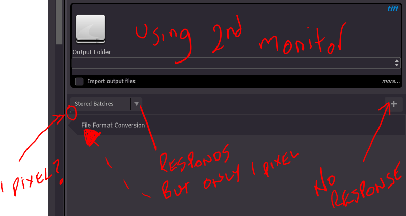

Have a bug in PS (latest version) when using second monitor attached to laptop.
Drop down arrow for stored batches responsive but produces only a tiny square (circled in picture). Also the "+" action is entirely unresponsive. If I move PS window to laptop window then these function correctly. I can reproduce every time.
Thank you

Update:
I can get the menu to open if I move PS to the laptop screen

Bump - is anyone else having issues with drop downs not functioning properly on a second monitor. Is really frustrating

G8DHE wrote: 19 Oct 23 17:52 Not sure what operating system your using, but its working OK here on multiple screens on W10 and W11, even moving the main panels around to each screen makes no difference.
Hi there,
Using Windows 10. No other issues in other software using dual screens. PS works on both screens it is just that I cannot use the batch tools at all on my second screen - one of the drop down menus will not work as per picture in my original post.

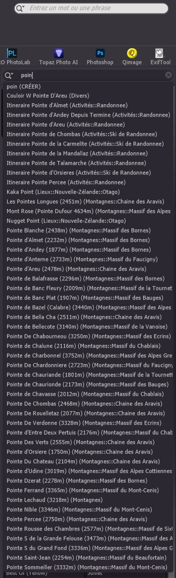

I'm also having display problems with my 2-screen configuration. It's not exactly like you but there are similarities.
The general search drop down menu, as well as the one for labels, only opens very partially (see screenshots below).

More details and possible cause of the problem:
My config :
- Desktop PC
- Windows 11
- Main screen : high end Eizo 27" 2k
- Second screen: more classic 24" 2k
I have the display problem when the main PSU window is open on the second screen.
If PSU is open on the main screen, no problem.
2023-10-20 15_17_49-Paramètres.jpg (147.42 KiB) Viewed 25388 times
But the aim is of course to see the full screen photo on the high end calibrated screen and to have thumbnails, image details, labels, etc. on the second screen. So this partial drop down menu opening is a bit annoying.
I also tested my 2 screens configuration with 2 different laptops and I had exactly the same problem.
However, I was able to test my PC on the following configuration: 2 IDENTICAL screens (Full HD and 24" for both screens). And this time there's no problem, the drop down menus open correctly whatever screen PSU is open on.
-> problem when PPI aren't the same on both screens ?

Have spent the weekend playing with screen settings but am still left with the situation where I am unable to use batch controls because the drop down and button controls are not functioning on the second (colour calibrated) monitor. As described before, I can only get these to work by moving PS onto my laptop screen (smaller).
Is there any work around for this or even a fix because this is a major issue for me.

Hi @Hert - I am wondering if this is a bug within PS - or whether you have any ideas for a fix if it is. I cannot currently use PS for any meaningful batch jobs without dragging it down to the small laptop screen where menus are functioning. My much larger colour calibrated monitor does not work with the batch menus and also any other slide out/drop down menus. This may not be a recent change within PS but more just a discovered glitch due to adding in a different monitor. All other software functioning.
If not I am in a bind
B
