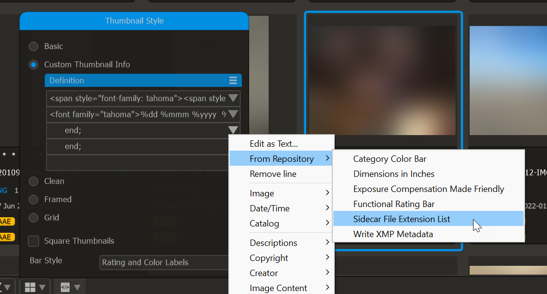

Posts: 7947
Re: Access Violation in meta contents area under thumb v2024
Thank you for your continued support.
The first and 4th line appear to be identical.
Click the drop down -> From Repository -> Sidecar File Extension List
marklevine
Posts: 65
Joined: 26 Dec 21 23:07
Post by marklevine »
Hert, I am unable to enter any script from the repository into my thumbnail information. For example, if I edit the custom thumbnail info to add a line by selecting "From Repository - Functional Rating Bar" I see "Access violation" in the thumbnail display.
