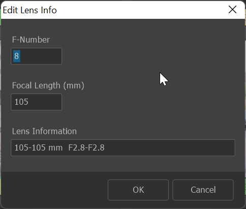

What just came to mind and which may help you.
There is a script that you can use to enter Lens Information.
1. Right click on an image thumbnail
2. Select Run Script from Repository -> Metadata -> Edit Lens Information.
This script will enter the details in the designated metadata fields.
