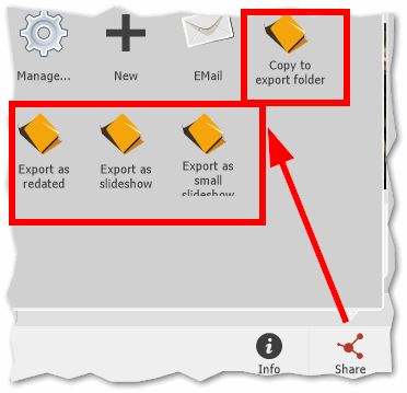

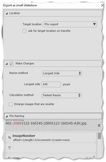

Re: How to Copy Images in a Portfolio to a Folder?
I have a number of scripts for copying, depending on the purpose. Note the icons can be right-clicked. See 2 attached screen caps...
- 2022-01-06 08_47_32-Window.jpg (31.11 KiB) Viewed 2635 times
- 2022-01-06 08_46_12-.jpg (19.55 KiB) Viewed 2635 times

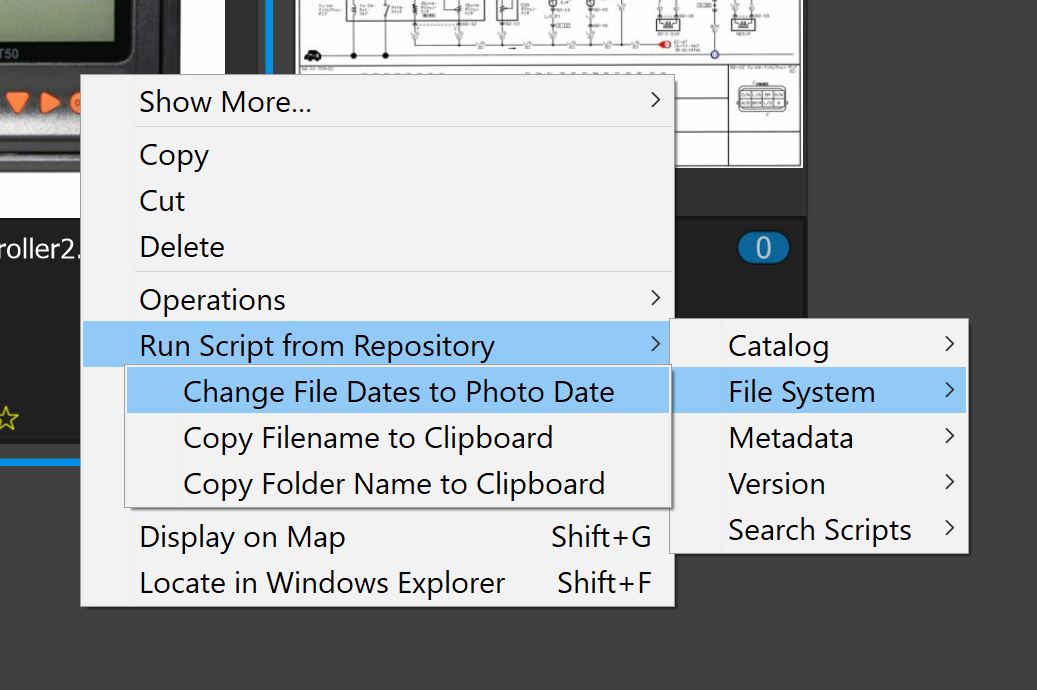

Can you not use;
to reset the dates to those of the photo ?Geoff Mather (G8DHE)
Hi G8DHE,
Thanks, but I don't think that helps. The create and modified date for the files in the collection are already set correctly. Your suggestion would fix them if they were wrong, but they're not. What I want is to keep the correct dates in the files when I copy them somewhere else where I don't want to catalog them.
For my particular use I can circumvent this problem so it's not a big issue for me. IDImager did this right (copy/paste without changing date stamps). Intuitively it seems like the obvious thing to do, and I just wish it worked as it did in IDImager.
Mike
