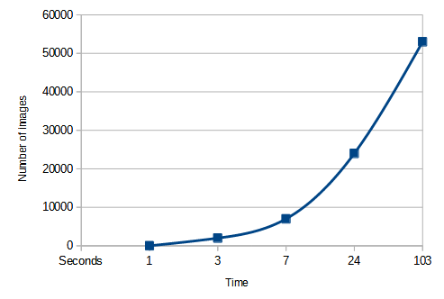

It's running OK so far, however switching from a folder with 1 image to another with 24K is now taking more time on my machine rather than less:
Build 3705: ±17s
Build 3755: ±24s
Which is puzzling if it should be doing the opposite. Looking at the SQLite Change Log, I see that version 3.36.0 reversed a change made in version 3.35.0 "as it was found to slow down queries more often than speed them up". I wonder if that may offer an explanation?

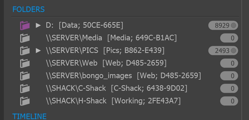

One oddity has shown up its identified all the other drives on my \\SERVER without me doing anything only the \\SERVER\PICS was previously selected ?
\Media, \Web etc were not included, I'll try removing them see if they stay removed ?
Edit: Removing them seems to have worked and they haven't reappeared after closing and restarting.

Hert wrote: 29 Jun 21 21:39 the performance improvement comes from an improvement in the software, and is unrelated to the database system used. maybe try to compact and try again. and keep preferences as default as possible. 17 seconds to open 24k images is dramatically slow. as mentioned, on my outdated laptop it does 20k in 2s, which was 4s in the previous release. maybe you're not using ssd?
I compacted the database overnight it's still taking around 23 seconds to open 24K images; as the previous compaction was last week the similarity wasn't too surprising. I've also just tried build 3758, just in case, with the same result.
I've run some further tests with varying numbers of images, and the result looks like this:
On to positive side, I can still move between tabs within 1 or 2 seconds, and I do that much more than opening large folders of images.
Yes, this running on an SSD (there is only an SSD, a 1TB Samsung SSD 850 EVO) + 10GB RAM + 2.40 gigahertz Intel Core i7-3517U
