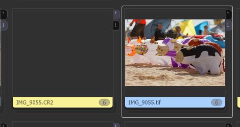

I'm developing my CR2s with DxO (current version: PhotoLab 2). Sometimes, especially after editing the development settings, the respective thumbnails are not displayed any more in PhotoSupreme. The viewer doesn't show the image either. So far, I don't know how to reproduce the probelm, which, to put it less systematically, shows up now and then ;-)
What to do? Bug? User misbehaviour...? Any idea?
Here's a screenshot of a CR2/TIF pair as displayed in the browser:
Missing CR2/DxO thumbnail
(Sorry if tis question has been posed already, which didn't seem to be the case for me when searching the forum.)

What happens when you switch off the setting Preferences->File Handling->DxO Edits support? Then select the blank thumb and press Ctrl+Alt+T (Windows) or Cmd+Opt+T (macOS).

Thanks for your quick reply, Hert! CR2s are displayed when following your instructions. Primary problem solved, then.
