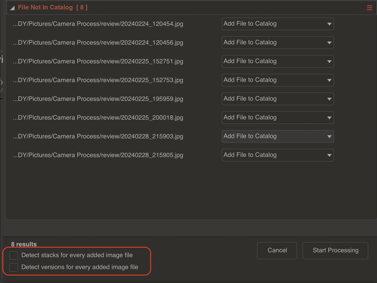

As far as where to disable stacking or versioning, for the Verify Folder interface, uncheck the boxes at the lower left:
Screenshot 2024-03-02 at 6.20.48 AM.png (466.35 KiB) Viewed 3297 times

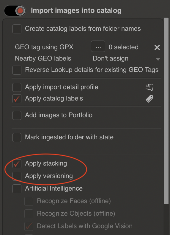

If during import, select the "More settings" button, then uncheck the selections as shown here:
Screenshot 2024-03-02 at 6.23.39 AM.png (274.1 KiB) Viewed 3297 times

Thanks a lot Hert and friends for your help. My case should have been in the ingest process. Problem solved!

roddyt - That's what I needed. I totally missed that box in the lower left corner during verify. Haven't seen any new stacks lately!
