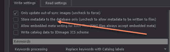

Re: Can't sync catalog and images
Maybe you have activated this property in settings?
