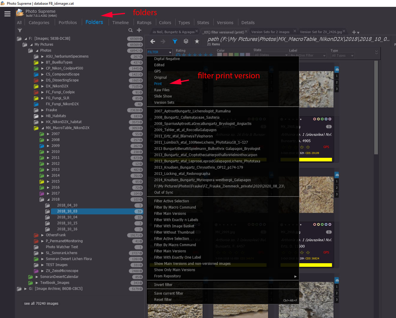

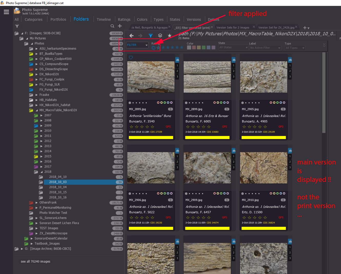

I just tried:
It is no longer possible to filter any versions !!!
The MAIN version is always shown, no matter what filter I apply.
After applying the filter:
It makes versioning completely unusable. It means, the only option to display a specific version is by manually clicking on the tiny tabs.
Good luck doing that on a huge portfolio collection.
It was so easy:
I filter all the NEFs, go to PhotoLab, generate my print versions, back in PSU add those print versions, collect the ones I want in a portfolio collection, and share them to upload them online. i did this all the time. Apart form databasing images, this is what I mostly use PSU for. Versioning is so useful.
And no:
I cannot use stacks for this! Stacks are different images, all from a Panorama and/or focus stack. And I cannot add placeholders to stacked images, and I cannot filter for a specific image in a stack. That is what versions was designed for.
PLEASE:
Can we have the old way how this worked back? It worked perfectly.
I do not understand why this has changed.
This must be a bug!

Re: Type filter shows only "All JPG" in v7
BTW - I thought I discovered a workaround by selecting all files - "right click - show more - from this version set" - displays all versions, even if many files are selected. Great!
But then trying to apply the filter to show only specific versions from these version sets: doesn't work.
So, you can display all versions side-by-side. But it is not possible to show a batch of specific files, say "all raw files", "all NEFs", all "print versions", etc.
The only way you can do that is to manually select the minute version tab for one file at a time.
Again: with a huge collection of images, this takes forever.
I have been a user of Photo Supreme when it was still called IDimager. And at least in Folder view, versions were ALWAYS displayed side-by-side. The logic here: Folder view would show you what is on your harddrive = all the files, all versions! That made sense, but occasionally confused people. Still, this was never changed through the history of IDI and PSU.
What did change: for quite some time filtering for specific versions was not possible in views other than the folder view. I remember that for a long time I had to manually click through a portfolio collection to select my "print" versions. I was sooo happy, when that changed and it became possible to simply click "Filter - Print" to have all my print versions displayed.
And now this has been removed. Why ????
I noticed one more behavior that makes no sense to me:
In portfolios it is possible to manually select the version that one wants (by clicking the little version tab). That selection is then saved, if you go somewhere else and return to the same portfolio, the same version previously selected is shown. Good. At least this way you do not have to do the meticulous selecting of versions in portfolios over and over again.
BUT:
After selecting a particular version, perhaps you want to quickly use a filter to return to the main version?
That does not work. Once you have manually selected a version, no matter what filter you apply, the selected version is ALWAYS displayed, until you manually change this again by clicking on the version tab.
This means:
When you use version sets, filters simply no longer work. They only work on images that are not versioned.
Ironically: why can you filter for versions, but only for images that are not versioned?
If I assign an image to the "print" version, I cannot filter for it. If I do not assign an image to the "print" version, I cannot filter for it either. This means, filters have become useless.
I really believe this cannot be intended.
