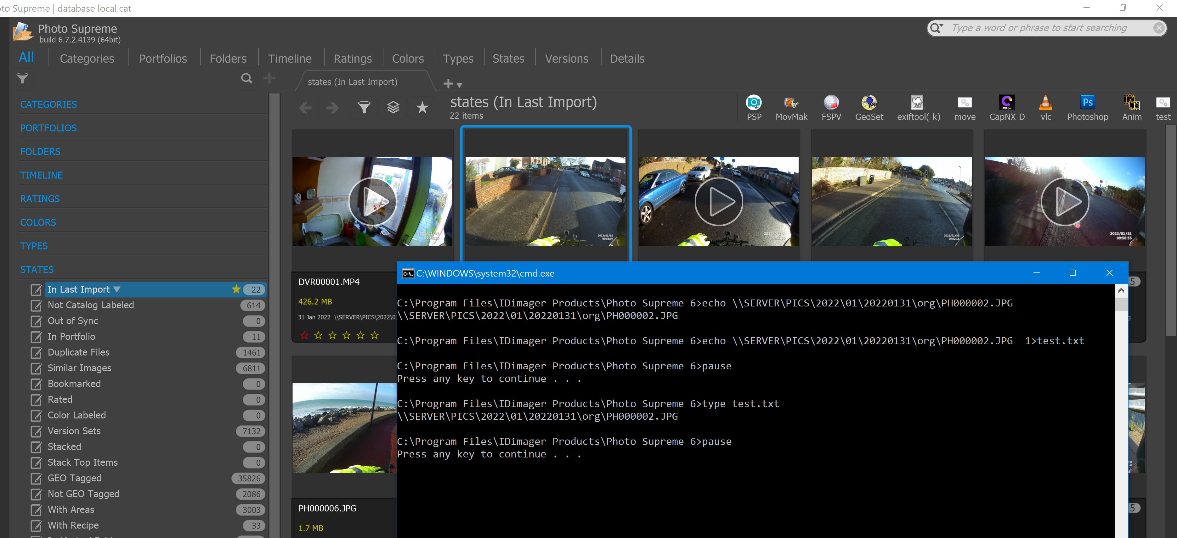

Re: How to add a script in the context menu
Seems Ok here!
My batch file
echo %1
echo %1 > test.txt
pause
type test.txt
pause
Clicking it results in;
