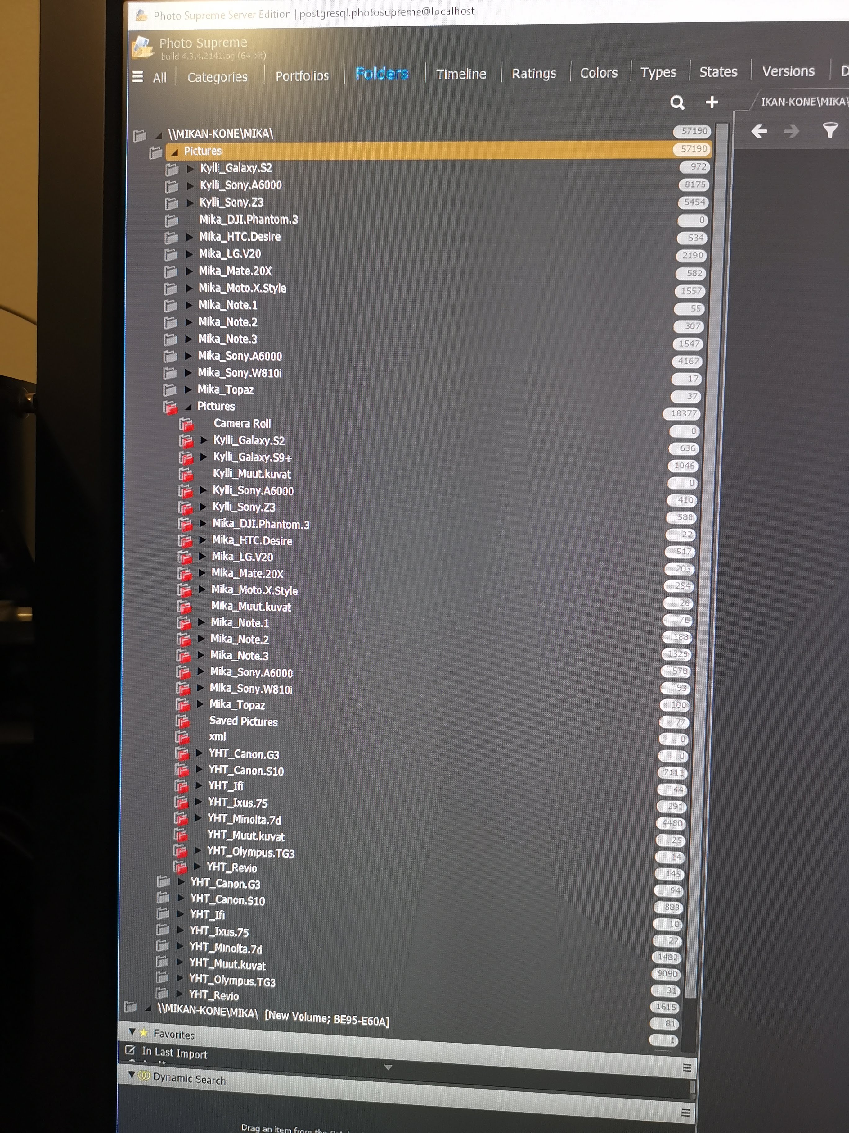

Had this problem on my wife's computer acting as a client with all the folders were red. Mapped folder to my computer pictures folder witch have the original pictures and got her folders gray on her computer. Now my computers folder structure is completely changed (used all to be under pictures folder) with some been intact and some new sub folder showing red.
It was quite hard to find the fix for her machine and now I have created yet another problem to fix. I can't for the best of me to understand how anyone can operate this program?

I see that you’re using the Server Edition. The purpose then is to import images from a central (shared) location that is accessible from both you and your wife’s computer. Apparently you’re taking another route.
You can, of course, also catalog images from your local hard drive. And that is what you’ve been doing. Then your wife can also find your picture (and visa versa) but the originals won’t be accessible from the other computer. Her local folders will turn red on your computer and your local folders will turn red on hers. That’s fine, you don’t have to relocate those.
In short, if you both want to have access to the original files then store the images on a central computer within your network...that can also be a shared folder on one of your personal computers
