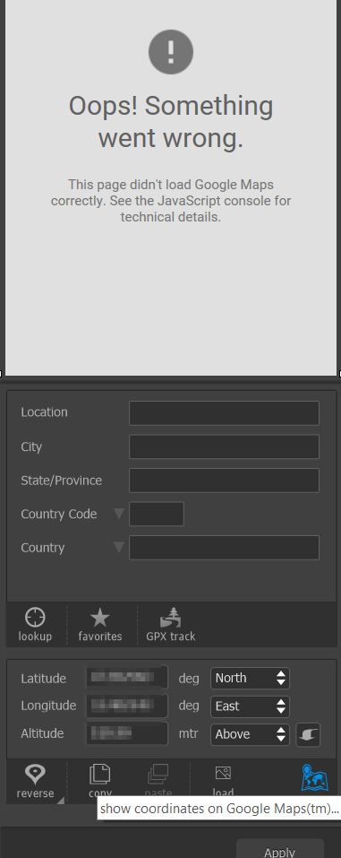

Today I tried to do some geotagging and it's not working. I get the following error:
"Oops! Something went wrong. This page didn't load Google Maps correctly. See the JavaScript console for technical details."
I've checked my key is correct.
Any ideas?

It seems that the Google Maps lookup works, but not the embedded maps in PhotoSupreme
If I click on "show coordinates on Google Maps(tm)..." it opens up my browser and shows the location correctly.
See attached.
See attached.

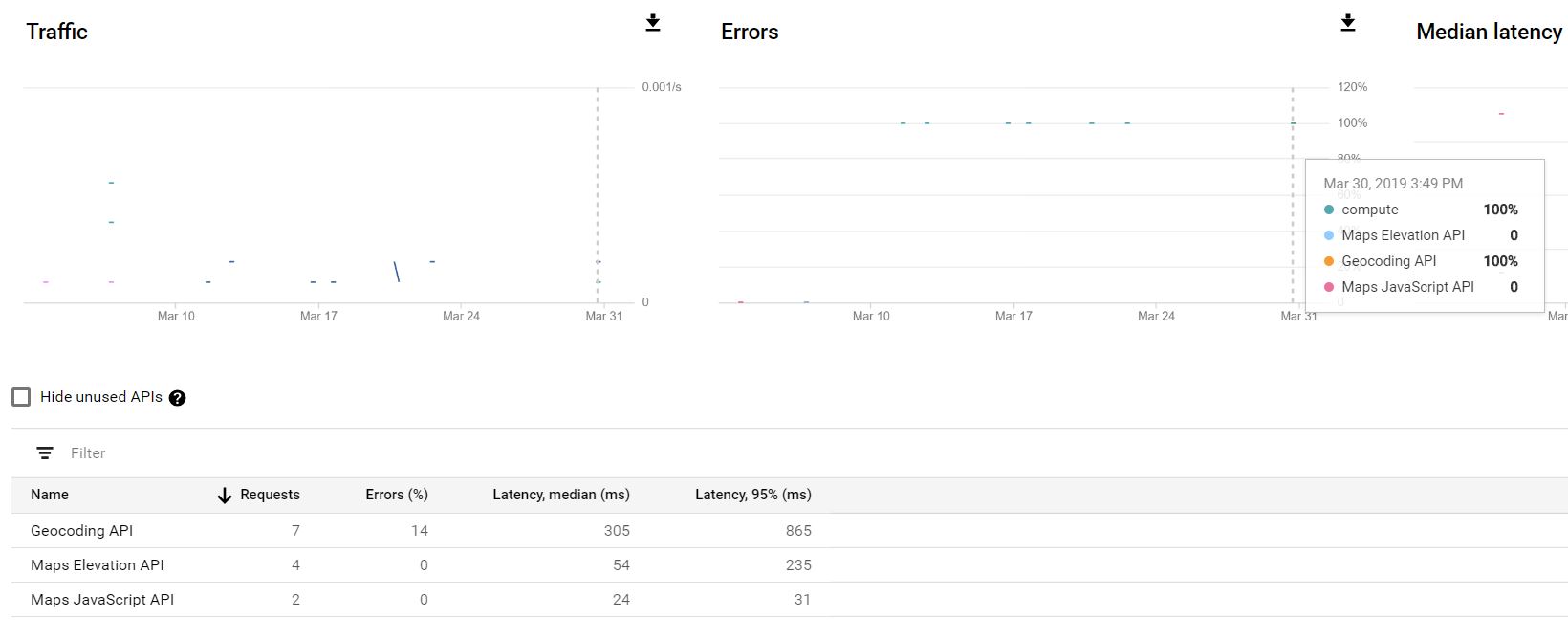

In case it is helpful here is a shot of the API console. Most of the errors are "compute". As you can see there are geocoding errors also.
Billing details and a valid payment card have been checked. During February and early part of March everything seemed to be working fine. I've made no changes since then apart from PhotoSupreme updates.

"Show Coordinates on Google Maps" calls the Google Maps website. That doesn't use your API key and will always work, even without API key.touriga wrote: 01 Apr 19 10:57"show coordinates on Google Maps" works so this seems to indicate that authorisation is working ok
The API key is used to display Maps inside the application, reverse/forward lookup, and altitude checking.

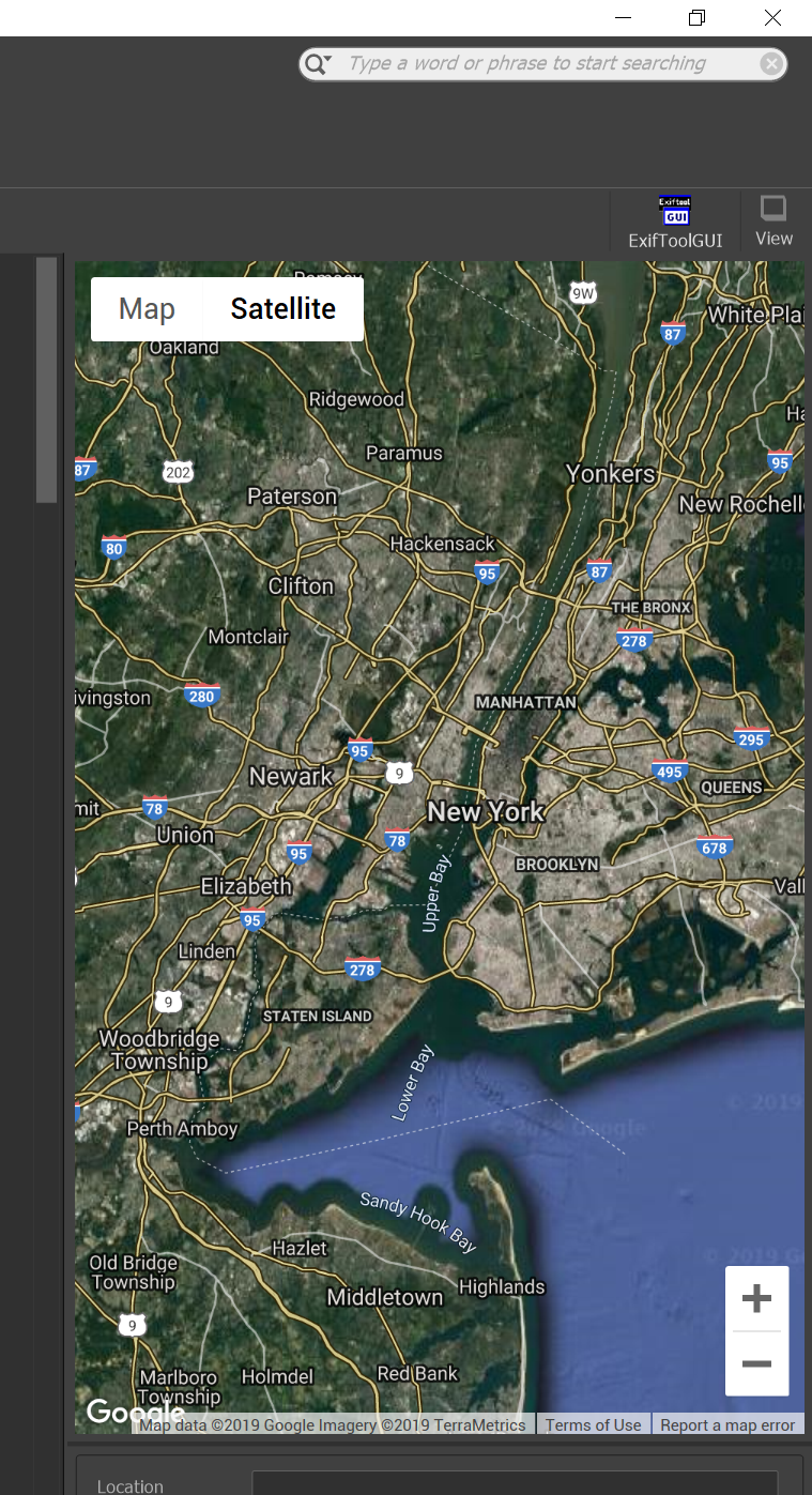

Everything is working fine here with my API key. And so I still think that your configuration is not correct. Did you also copy the Google API key to PSU's preferences? Try to copy/paste the key again.....could be that you missed a character?
Here's my Maps, and maybe other can chime in if Maps is working for them.

= SOLVED =
I had an IP address restriction in place and since using it successfully a month ago my IP address has changed. I have now removed the IP address restriction and all is working fine.
