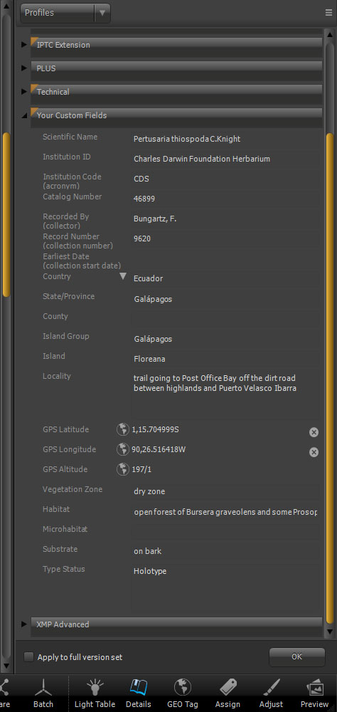

Hi Phil,
your custom fields from the Info Panel are all displayed by default in the Details Panel too under the header: Your Custom Fields, see this screen shot:
BTW - in the example shown, most of these fields are no "true" ICS custom fields, but the fields that I chose to add to the Info Panel. You can add any existing XMP field to the InfoPanel including your own, new ones, to better explain this: And all the fields displayed on the Info Panel will show up on the Details Panel under Your Custom Fields.
What unfortunately is NOT possible is adding these fields in the Details Panel to another category different from Your Custom Fields.

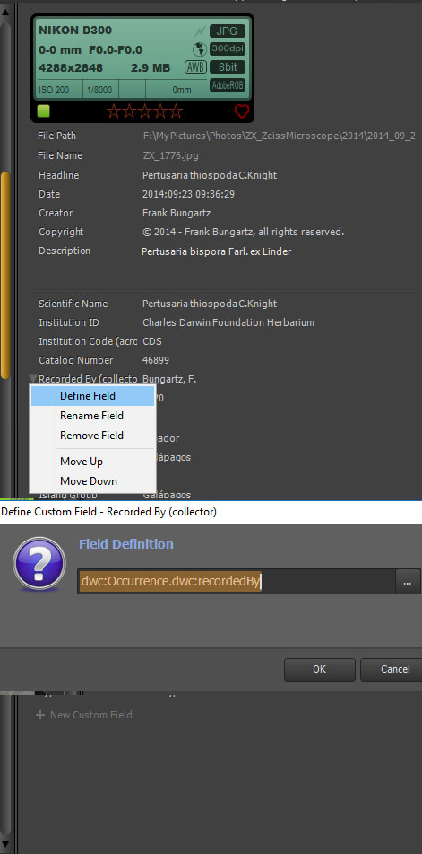

Re: Move the Custom Fields from the Info button to the Details button?
fbungarz: "BTW - in the example shown, most of these fields are no "true" ICS custom fields, but the fields that I chose to add to the Info Panel. You can add any existing XMP field to the InfoPanel"
To my surprise* some of these existing XMP fields do not appear on the Details panel.
Example:
Info Panel -
Details Panel -

Phil, I'd like to add only that your "true" custom fields also appear under Details -> XMP Avanced -> icd

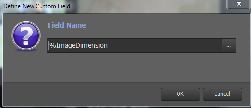

@snapphotgn:
This is not correct. You can add ANY XMP field to the Info Panel, BUT you need to know its correct XMP syntax.
In your case: "'%ImageDimension" is simply incorrect, no wonder it does not show up. Try this:
Or select it from the DropDown menu (whether the "Advanced" section is available in the drop-down BTW depends on which XMP schema you have displayed in Image Details: Basic , Advanced, IPTC, DarwinCore or DarwinCore Xpress.
%exif:ImageDimension

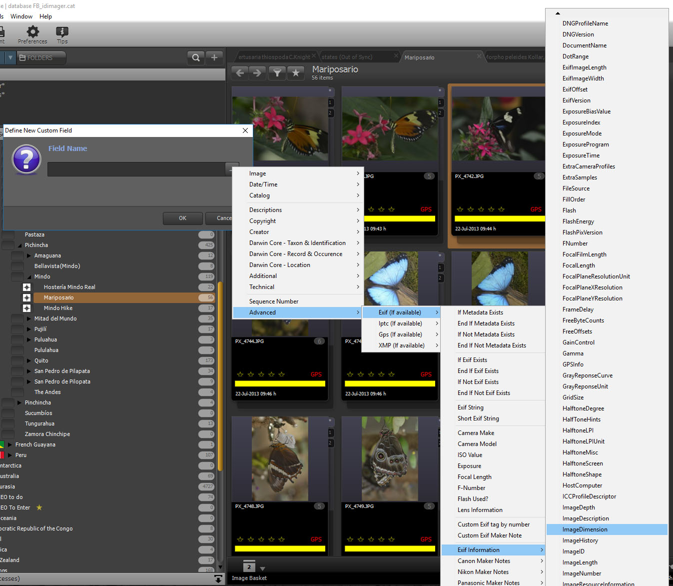

I took what the machine gave me. Didn't type it in.
If you fly out to Image and get Image Dimensions, you get this: %ImageDimension
If you fly out to Image Dimensions in your screen print, you get this: %exif:ImageDimension
Either one is not visible in the Details panel or the Catalog.
I have tried several Maker Notes fields using the same method and they do not appear in the Details panel or the Catalog.
Strange: '%ImageDimension works for me in Info Panel, although it doesn't show up in Details > Your Custom Fields. Exactly the same for %exif:ImageDimension. Frank, do you see something different on your system?In your case: "'%ImageDimension" is simply incorrect, no wonder it does not show up.

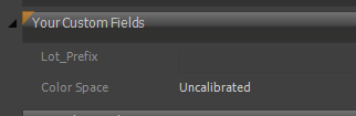

OK, my mistake indeed! I believe this should be filed as a bug. I thought you were saying 'ImageDimensions' were not showing up at all. Now I see that you are saying the field gets displayed on the Info Panel, but not on the Details Panel under "Your Customs Fields".Strange: '%ImageDimension works for me in Info Panel, although it doesn't show up in Details > Your Custom Fields. Exactly the same for %exif:ImageDimension. Frank, do you see something different on your system?
I checked it right now and you are correct. I first thought this might have to do with the field being a technical metadata field that is locked for editing. But then, you can add the GPS fields, which are also locked (cannot be edited) and they do show up both in the Info Panel and the Details Panel.
Strange. I think this must be a bug...
