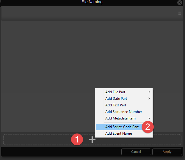

To fix it:
1. Clear the rename rule what you have now
2. Click the + icon
3. Select Add Script Part
4. Copy/Paste the script

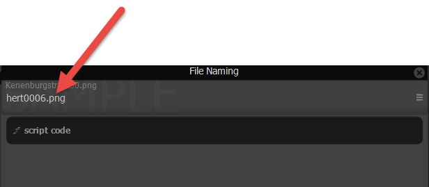

You should see correct a sample file name:

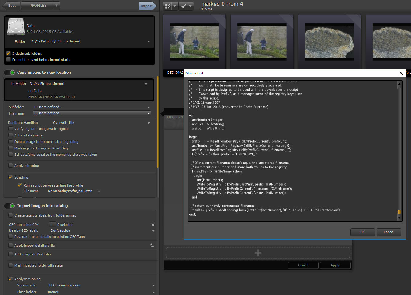

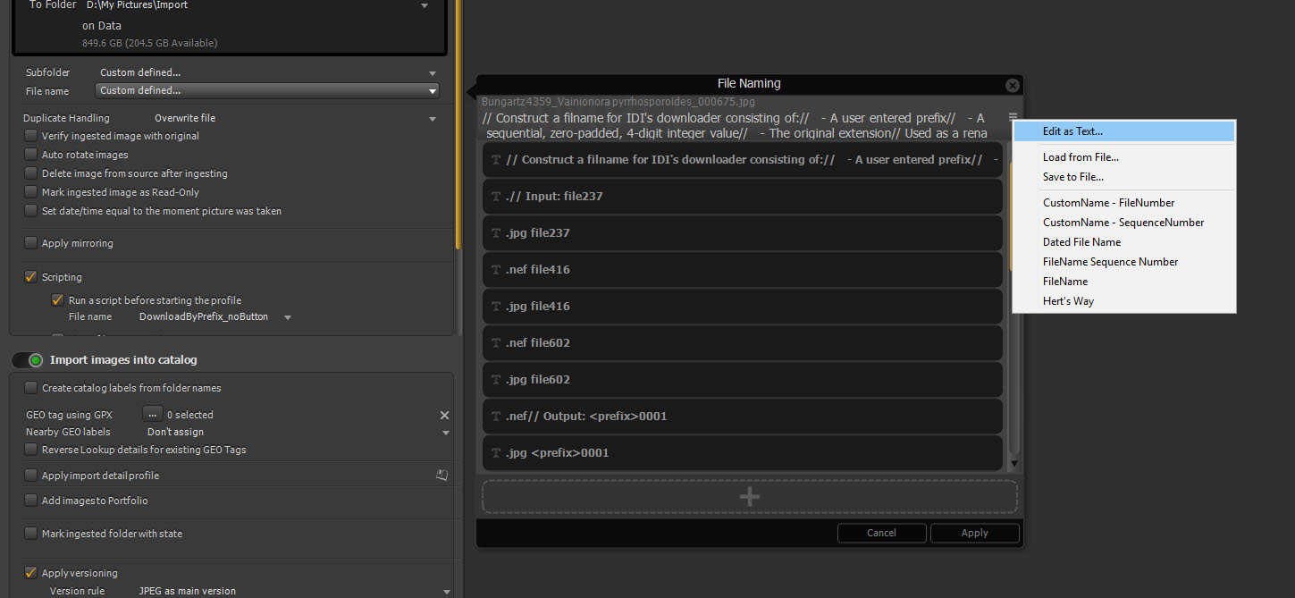

Looks like I am a bit thick, do you mean I need to paste the " "DownloadByPrefix_RenameRule.txt" as script code part?
This would explains why it does not work. I thought I had to paste it into the text window, here:
like so:

Hurray!!!
It works.
Sometimes pictures (screenshots) say more than a thousand words.
