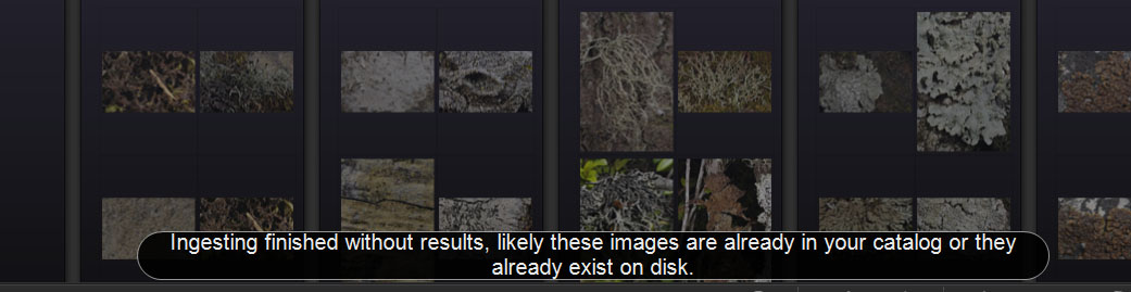

Hello!
I have a strange problem - I am trying to import images from an SD card. When I select the appropriate images on the card and ask PSU to import them, it appears to fire off an activity that zips through the images and then a messages says the PSU did not ingest anything because the images are already in the catalog or on the disk. The images that I am trying to import are brand new images.
Anyone know what I could be goofing up?

The message is: "Ingesting finished without results, likely these images are already in your catalog or they already exist on disk".

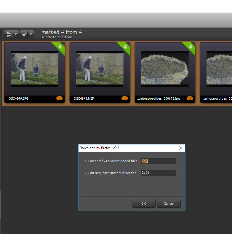

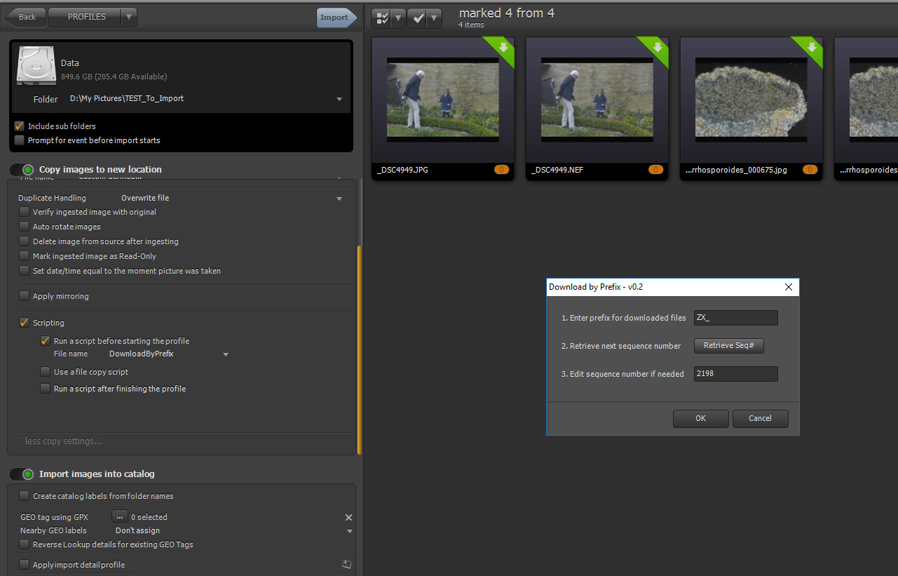

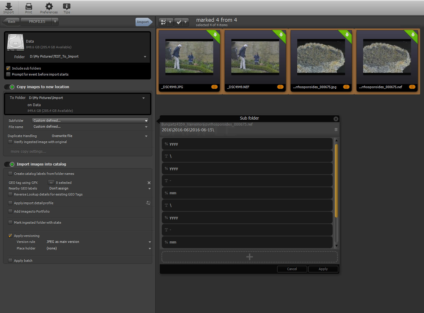

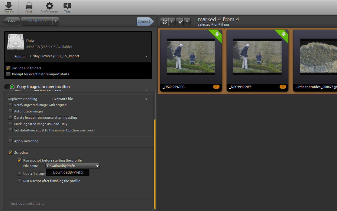

Here my first screenshot with my subfolder rule: Then the rename rule:
As applied in this screenshot:
Followed by an import script:
This is the script:
When I execute the import, a popup box first asks me for the prefix and the number that I want to use:
I add the number:
(see next post, apparently I reached the max. number of attachments...)

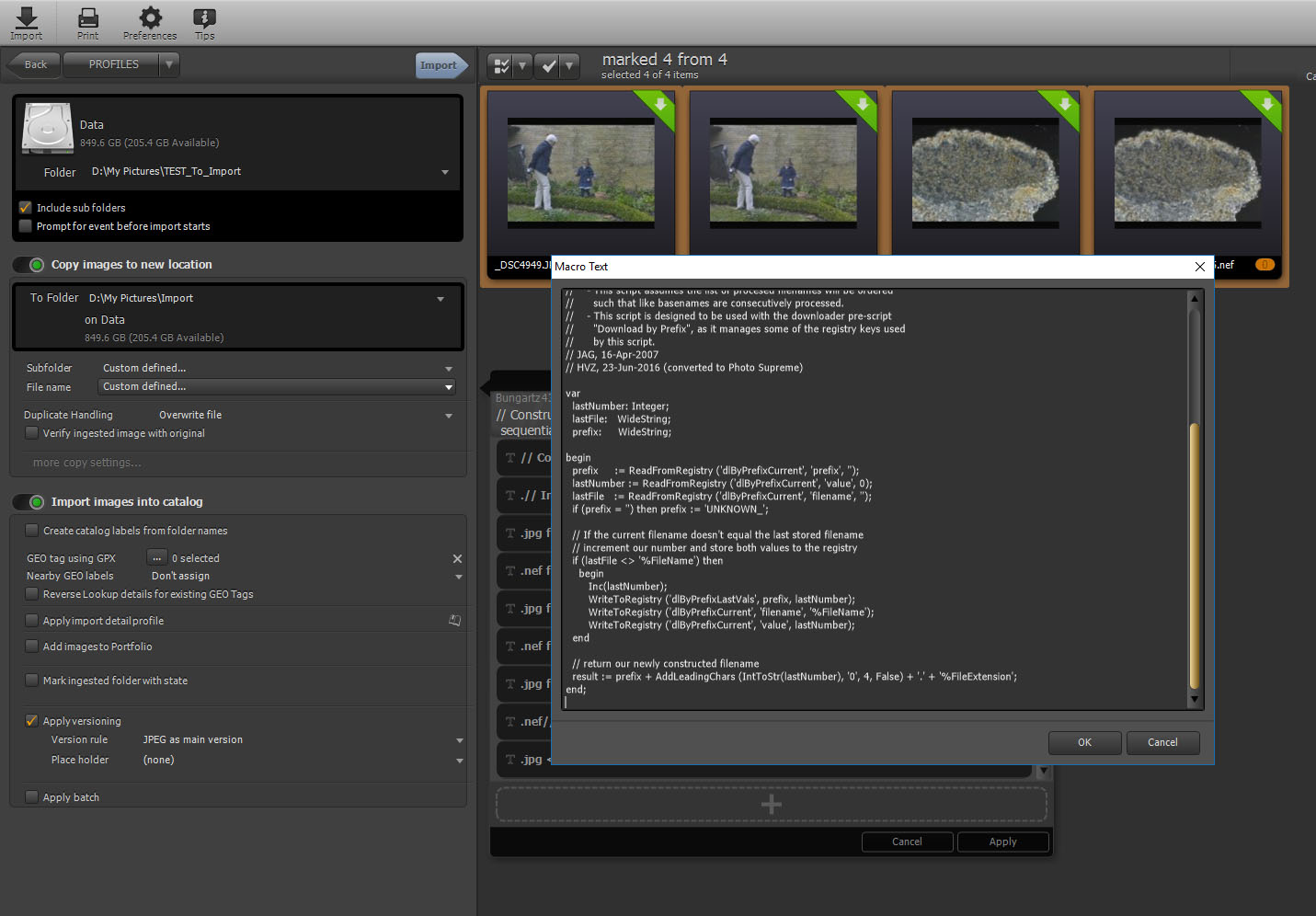

// Construct a filname for IDI's downloader consisting of:
// - A user entered prefix
// - A sequential, zero-padded, 4-digit integer value
// - The original extension
// Used as a rename script, this will allow a "group" of common basenames to be
// renamed with the same integer value.
// Input: file237.jpg file237.nef file416.jpg file416.nef file602.jpg file602.nef
// Output: <prefix>0001.jpg <prefix>0001.nef
// <prefix>0002.jpg <prefix>0002.nef
// <prefix>0003.jpg <prefix>0003.nef
// Notes:
// - This script assumes the list of procesed filenames will be ordered
// such that like basenames are consecutively processed.
// - This script is designed to be used with the downloader pre-script
// "Download by Prefix", as it manages some of the registry keys used
// by this script.
// JAG, 16-Apr-2007
// HVZ, 23-Jun-2016 (converted to Photo Supreme)
var
lastNumber: Integer;
lastFile: WideString;
prefix: WideString;
begin
prefix := ReadFromRegistry ('dlByPrefixCurrent', 'prefix', '');
lastNumber := ReadFromRegistry ('dlByPrefixCurrent', 'value', 0);
lastFile := ReadFromRegistry ('dlByPrefixCurrent', 'filename', '');
if (prefix = '') then prefix := 'UNKNOWN_';
// If the current filename doesn't equal the last stored filename
// increment our number and store both values to the registry
if (lastFile <> '%FileName') then
begin
Inc(lastNumber);
WriteToRegistry ('dlByPrefixLastVals', prefix, lastNumber);
WriteToRegistry ('dlByPrefixCurrent', 'filename', '%FileName');
WriteToRegistry ('dlByPrefixCurrent', 'value', lastNumber);
end
// return our newly constructed filename
result := prefix + AddLeadingChars (IntToStr(lastNumber), '0', 4, False) + '.' + '%FileExtension';
end;
Re: PSU not Ingesting images
...continued.

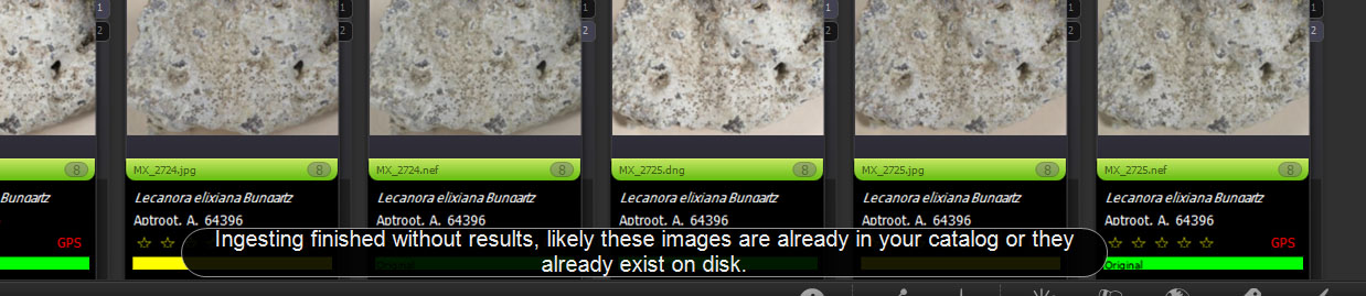

I add the number: and click OK.
Then I am told that ingesting did not work, supposedly the image files are either already in my catalog (they are not, else I would not try importing them) or on my hard drive (of course they are on the hard drive!)
No idea why this is not working.
Vlad - could I ask you to try it out? Hert reports that it is working on his system...

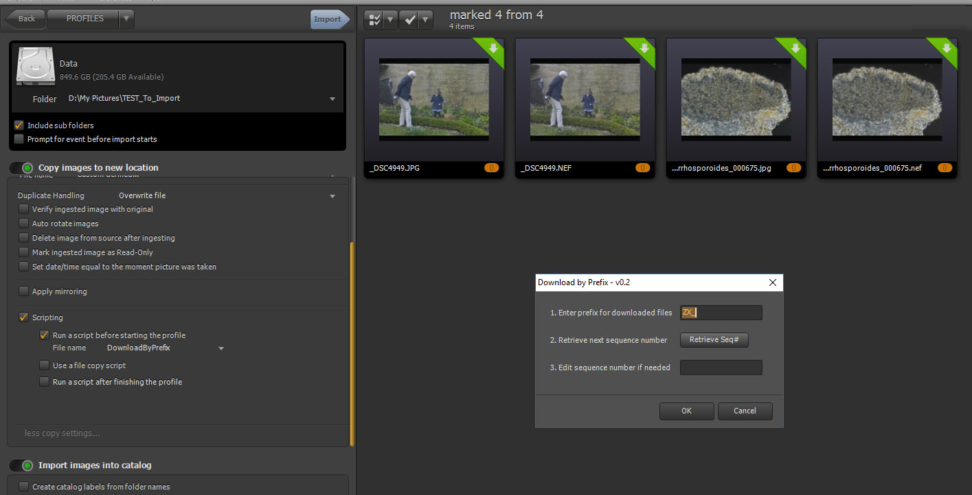

That is not the last version of the download script Frank. The button to retriever the number should not be there
Yes, I know, it is the one you used, though. And you sent me your screenshots that it was working!
I tried the last version too, the one where you removed the "number retrieval button" too. It gives me the exact same results. No difference...
[I am not quite sure, which one of the two I prefer actually, so, I have been trying both...]
Below the screenshot that this one too does not work on my system:
