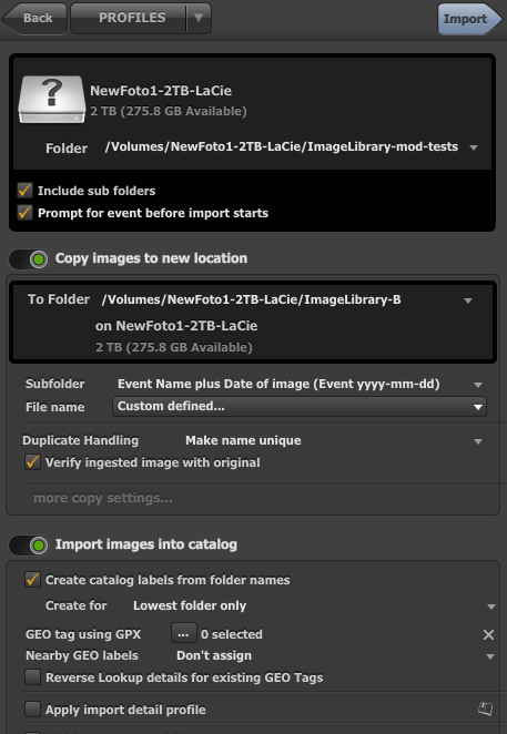

Help, what is going wrong? I am trying hard to get this workflow to function correctly.
I opened C1 from PSu and edited a RAW image, which I then processed in 3 variants, small jpg, large jpg and large tiff. All 3 images show all EXIF data according to the Mac Finder (equiv. of Windows Navigator).
I then imported all 3 images into PSu using my regular import template below. The description, location and other META data is shown on each image and also the lens model. However, the remaining data in PSu's "Technical" fields is not shown, like aperture, shutter speed or even the date and time the image was taken. I'm at a loss!

Looks like some tool leaves you with half baked XMP...the first tool that creates XMP must also convert technical matadata from Exif to XMP. You can fix your XMP with PhotoSupreme. Right click on a file and then select Metadata->Convert Exif to XMP (something like that, I can't check it).
More importantly...find out what tools creates XMP without converting the technical metadata to XMP.
