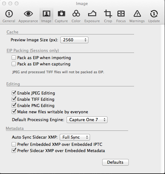

C1 is certainly writing cos files. Here is a screen shot with the only preferences screen where I see any relevant settings. The drop-down box "Auto Sync Sidecar XMP" has the options of none / load / full sync.IDimager wrote:PSU works with Cos files. When you configure C1 to not write Cos files then PSU can't see the edits.
Since un-clicking "Prefer embedded XMP" I am getting countless error messages "Could not generate XMP file".
If I manually change meta data, like description in C1, this is automatically seen by PSU. If I change it in PSU, it is only transferred when I specify. However, image edits made in C1 are not seen in PSU.
I cannot find documentation on intercommunication between applications. Can anybody help please?
