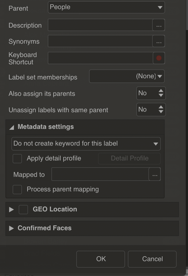

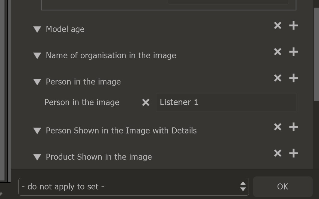

I'm also attaching screenshots of the settings for one of the "people" which is not correctly linking to the IPTC fields. Could you please let me know if anything is incorrect? For example should I be selecting "Auto assign its parents" or "process parent mapping"?
Thank you
Thank you
- Screenshot 2024-11-16 at 7.57.36 PM.png (634.27 KiB) Viewed 11536 times
- Screenshot 2024-11-16 at 7.56.52 PM.png (358.02 KiB) Viewed 11536 times
Re: Question about People label metadata
You are hitting the "OK" to save button on the lower right corner of the Details screen ? I know myself its very easy to forget tucked down in the lower corner!
Thank you very much for the help, but I'm not sure I understand.
My understanding of the process - I add a people label to a photo, and based on that label, the person's name should be automatically added to the "Person in the image" field for any photo which has been tagged with that label, correct? I don't understand at what point in the process I would be required to open the details view (shown in your screenshot above I believe) and press ok.
What am I missing here?
Don't think your missing anything, it was the fact that you said you selected the "details" pane, I was thinking of the "Details pane" that appears on the right-hand side, but your referring to the details section for the Labels. I don't often have any reason to change the configuration "details" pane you mentioned. In my set up that the IPTC fields are configured under Preferences settings by default.
My normal process is just simply drag and drop the Label required to the image(s) and drop it on them, or enter the Label name on the right-hand pane when "Labels pane" is selected.
Have you tried simply dropping the Name label required on the image required and then checking to see if the Label has been assigned and then check the "Details pane" for the correct update ?
