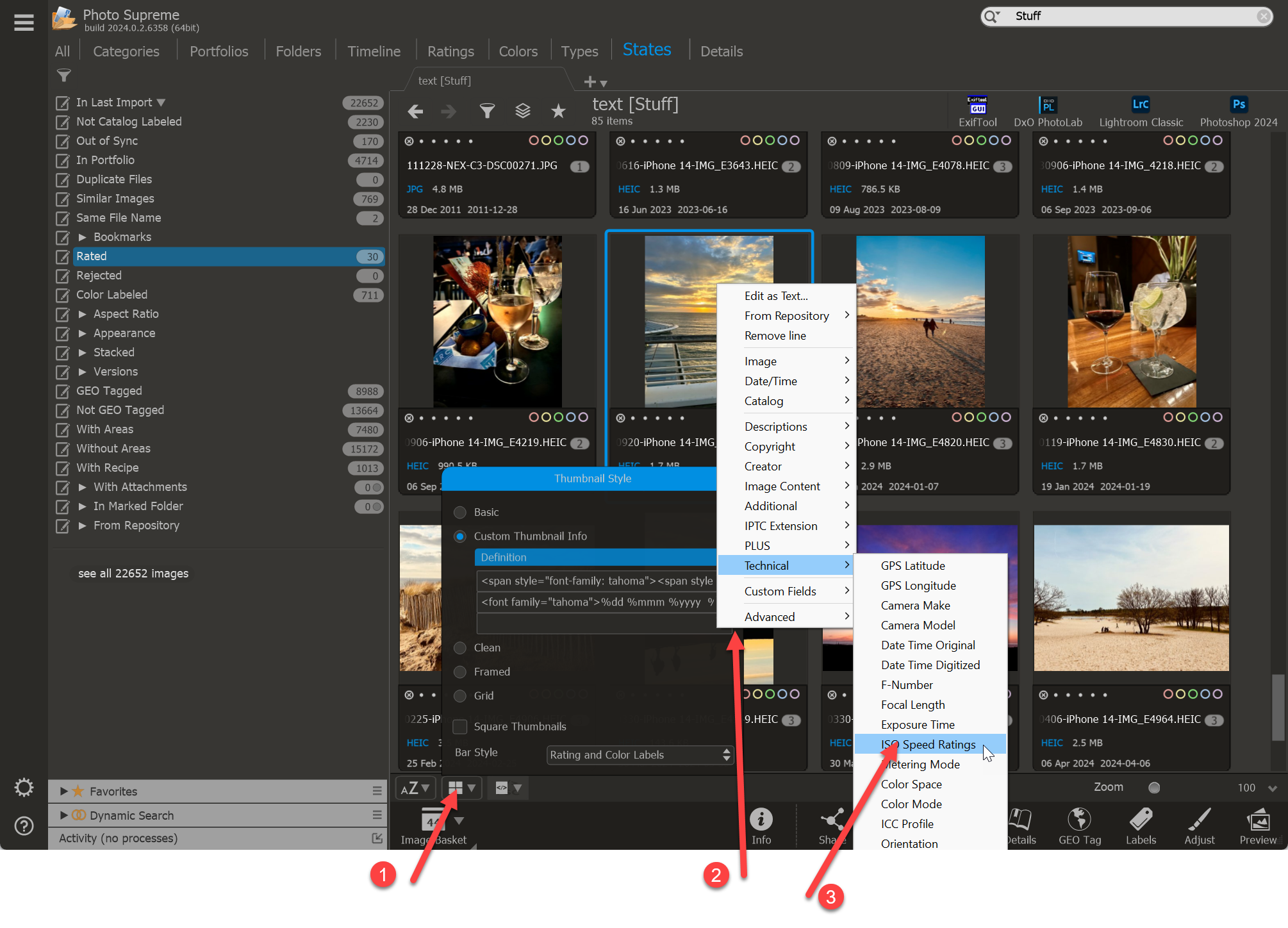

Is it possible to configure the info that is displayed on thumbnails? I would like to have some EXIF data displayed - ISO, shutter speed and f-stop.

You can configure what is displayed below the thumbnails. Click the button for that below the thumbnails.
Then for a new line click the drop down and select the macro what you need. You can add multiple macros at the same line.
