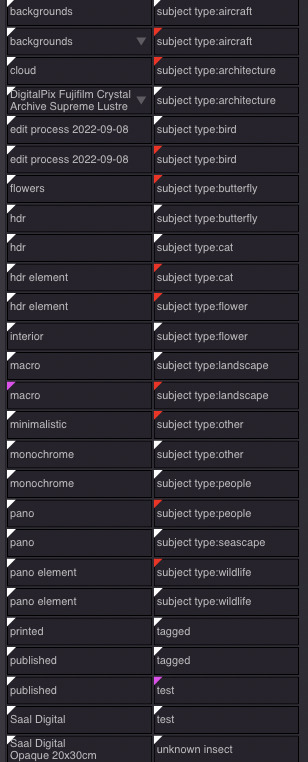

As mentioned in the forum, in December I re-imported all my photos in a clean catalog to fix a problem with thumbnails. I now see that in the "Favorite" keywords panel I have some "zombie" entries: that is, all the keywords I originally had now are present but not working. The contextual menu can be opened, but does nothing (so I can't remove them). I manually added again the keywords to be able to use them, and now I have duplicated entries (see the attached screenshot). Please let me know how to remove them. Scratching the whole favorites set would be ok, I could manually add those I need in a few minutes.

"Zombie" keywords are not shown in the Categories section: I can only see the new counterparts.
