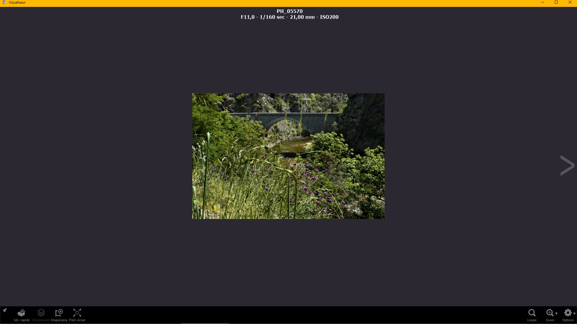

During slideshow (or when using image viewer), some of pics come from the database (image preview), not directly from the file itself. See the screenshot.
2023-05-10 19_36_30-.jpg (411.82 KiB) Viewed 8806 times
The size of the image preview is : 640 pixels.
In options, « Load full size image » is active.
It happens only sometimes.
If « Enlarge images that are smaller » is check, the image is blurry.
Quid ?

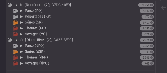

1. Check in Folders if there is a top level root folder that has a red icon
2. Make sure that you are not in Travel Mode
2023-05-11 10_42_20-Photo Supreme _ Base de données Tout.cat.jpg (45.27 KiB) Viewed 8790 times
Hello Hert.
No red icon, in any folder.
For image PH_05570.jpg (from the fisrt screenshot), « Locate in Windows explorer » works fine.
From PH_05570.jpg (for instance) : if I click on < to go to PH_05569.jpg, then click on > to PH_05570.jpg again, PH_05570.jpg is shown correctly (in full format).

No, it happens for any file, not always, from time to time, it is impossible to predict.
When using the viewer, I just have to change the photo (previous or next one), then when go back to that one which was small, then all is right (full screen). But with the slideshow, it is a little bit more uncomfortable...
