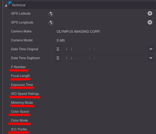

Unfortunately this failed, and if anything raised more questions. I exported a new fresh TIF from C1 (from the RAW file), with only the "Camera metadata" ticked. I then opened the new file in different applications with the following results:
- PSu - After import, PSu is NOT showing f-number, focal length, exposure time, ISO, color space. Empty.
- CaptureOne - All camera metadata shows as expected.
- Affinity Photo - - All camera metadata shows as expected.
- EXIF Pilot - All camera metadata shows as expected.
- MacOS (right click + more info) - All camera metadata shows as expected.
I also tried to exporting the TIF -> JPEG directly from PSu, and oddly enough all camera data is present in the resulting JPEG. Running a "Full EXIF dump" in PSu on the TIF shows the camera metadata is indeed there. PSu is also not adding the missing values to the "Details/Technical" filters (top part of the UI), but I guess that was expected. There are more oddities happening as well, but I'll ignore those for now (will be impossible to follow this thread otherwise).
Screenshots from each application:
- Photo Supreme
- PSu.jpg (49.16 KiB) Viewed 7702 times
- MacOS
- MacOS.jpg (25.53 KiB) Viewed 7702 times
- EXIF Pilot
- EXIF_Pilot.jpg (16.8 KiB) Viewed 7702 times
- Capture One
- CaptureOne.jpg (28.29 KiB) Viewed 7702 times
- Affinity Photo
- Affinity.jpg (23.97 KiB) Viewed 7702 times

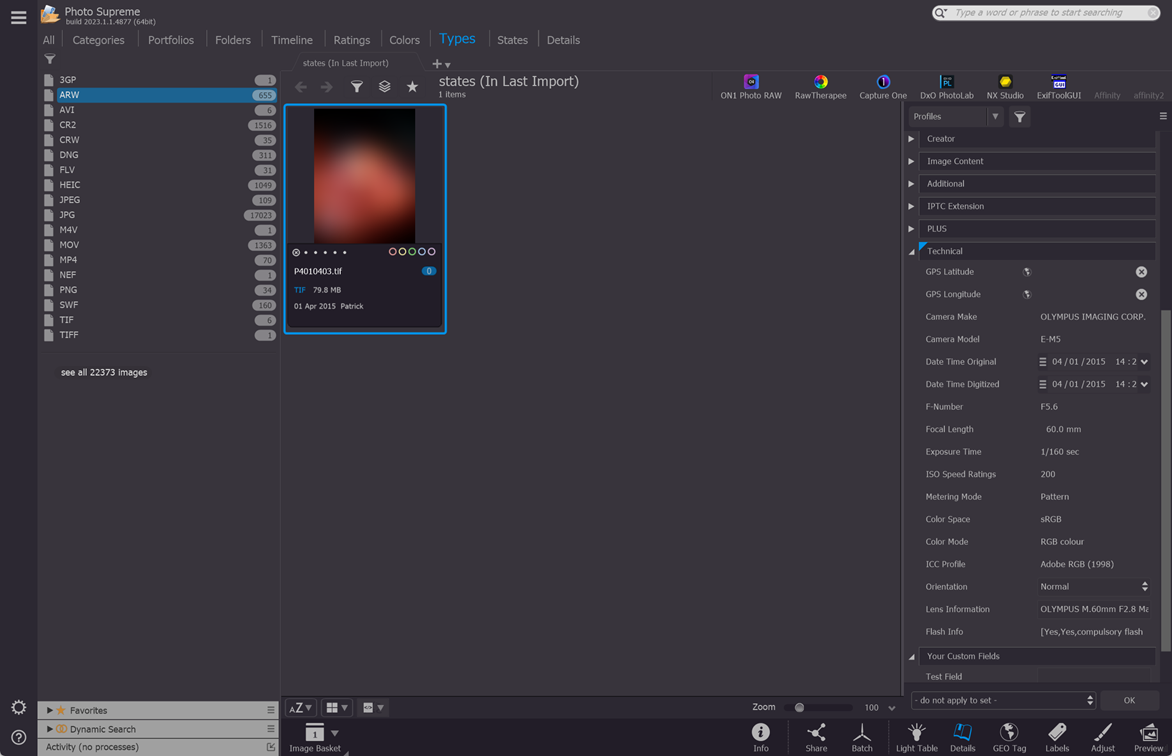

Re: Question about "Details" section
Can you send a sample TIF file to support@idimager.com
tia
tia
Of course - sending you the tiff shortly! Thanks!
Patrick
Thank you for the sample file.
I have imported the file and the technical details in the file are indeed empty. After that I did right click -> Metadata -> Convert Metadata to XMP and the technical details rolled in.
In addition to the above. I notice that the XMP in the TIF originates from an ORF file. I think that is because you imported the XMP from the sidecar file. But...to me that indicates that the tool that created the XMP sidecar file from the ORF is the tool that created the half baked XMP.
You could try to:
1. Use the "Metadata -> Convert metadata to XMP" option on the ORF file
2. After that import the XMP sidecar to the TIF
Does that make sense? Of course it would be better that the tool that created the XMP for the ORF did a better job in the first place.
You could try to:
