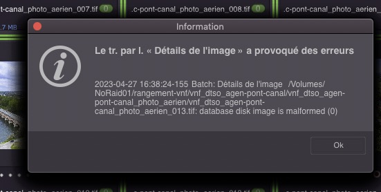

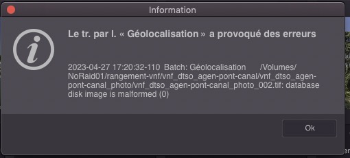

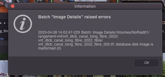

I've a new problem wit PSU :
impossible to syncronize "details", 'geo" and impossible write metadata in files.
(You can see the psu's message in attahcment)
I already do :
- rename the thumbs.db file
- Build missing thumbs and previews from the hamburger menu.
but nothing, i've allways the problem.
Do you have some idea please ?
(I do not hide that I am a little fed up with this software which often crashes)
Thansk a lot,
Damien
batch raised errors
batch raised errors
- Capture d’écran 2.jpg (46.41 KiB) Viewed 3158 times
- Capture d’écran 3.jpg (33.37 KiB) Viewed 3158 times
- Capture d’écran 5.jpg (40.06 KiB) Viewed 3158 times
Re: batch raised errors
The error seems to be indicating that you have problems with the image files themselves ?
Are they on the same machine as the program and database or running over a network from another machine ?
That message indicates that the database file is corrupted.
Best to restore your catalog from a backup.

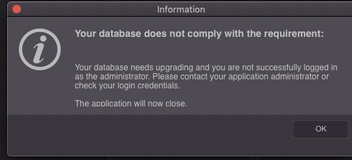

My database is on a local drive.
My files are on external drive.
My catalogue was not corrupted the last time i ue it.
It was ok to syncronise et put details et geo...
I want create a new catalogue but now i've the right and PSU ask me to update the database. Its a nonsense : i create it with with the last version of PSU. (see in attachement)
Damien
Damien
For a new catalog, make sure that you enter the default password
master2004
master2004
