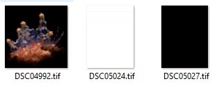

I've been working in the past few days on incorporating PSU into my workflow, and have been doing so while editing the latest bunch of photos from my last trip. It's been a great experience until this morning when I made a disconcerting discovery - about 20% of all my edited TIFs have become either entirely black or transparent. No image data seems to be left. When rebuilding the thumbnail in PSU for any of the affected photos I see the following instead of a new thumbnail:
"Invalid TIF strip found (0)".
I cannot say for sure PSU caused this, but I've never seen it happen before so my gut feeling is to start troubleshoot there. My suspicion is that this happened when the folder was re-validated in PSU. I know for sure the TIFs were OK yesterday.

Thumbnail in PSU after recreating it
How Windows File Explorer is showing the files (1st TIF OK, second TIF is transparent and third TIF black)
