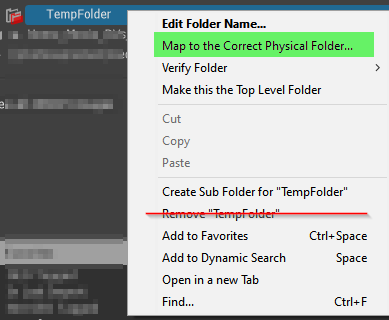

I just wanted to add a quick note to this topic with a visual to back it up to make the point for anyone that has a folder turn red due to having been moved, or a drive having disconnected, etc. Whatever you do, don't go the route of removing the now red folder from the catalog if you want any content linked to those files in the database to be preserved.
2022-03-07 01_32_09-M.png (11.84 KiB) Viewed 2038 times
While I take your description of the issue to indicate the folder was removed from the database by the time you asked the question, if the folder had simply been moved outside of PS, causing it to show up as red in the folder tree, you could simply right-click it and select the 'Map to the Correct Physical Folder...' option to point that to the new location, but removing that red folder from your folder tree dumps all the records in that folder and subfolders, with database-only labels being irrecoverably lost at that point (absent the backup which you fortunately had).
You can re-map individual files with the 'Map to the Correct Physical File...' option as well if necessary, but again only if you have not removed the original record from the database.
