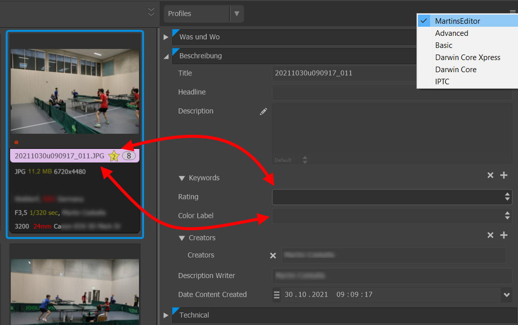

after some investigation I thought, that the internal name of the field has been changed, because I use a relatively old own "Editor":
My own editior with wrong rating and color label.
You can see, that the rating and color label on the left is not visible on the right.
Setting the rating with the keys 0,1,...,5 is still working.

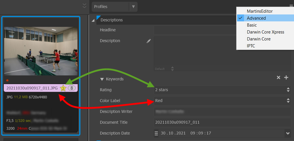

So I switched to the "Advanced Editor", but also here I see a mismatch:
The "Advanced" editor

Posts: 7928
Re: Ctrl+0 to remove Color Label does not work anymore (V.6.5.0.3955)
In the preferences (Catalog) you can configure the string that is written to the metadata for each of the colors. Please check that you have those configured correctly.
Yes, at one point those field names changed in the XMP specs (xap:Label became xmp:Label, same for rating), and subsequently this change was also implemented in PSU. Not recently but about 8 years ago.
There is no way to create or edit editors. Nor was this ever possible in Photo Supreme. You probably created your editor in the old IDImager software. The fact that such editor still works more than a decade later is pretty surprising. You should expect that at one point it will completely stop working after some a large change in the underlying model is made.
If you want to remain future proof then use the PSU editors instead. You can use custom fields (Info Panel) to create fields for your own need.

Nevertheless even in the "Advanced" Editior the "Color Label" ("Farbkennzeichnung") is not displayed when set via Ctrl+1,... or Ctrl+5. When selecting the color in the Editors Select-Box then it works.

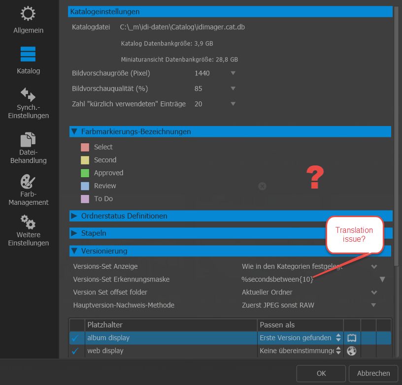

I wonder what Hert means with correctly configured colors in the configuration. I have currently:
Configuration
Configuration
By the way: Is there a translation issue in the Select-Box for the version recognition?

Posts: 7928
Check the color names in that page you shared. That is the string that is written as the xmp:Label when you assign that color.
Keep in mind that when you change the string then you need to reassign the color label to get the changed string in the metadata. xmp:Label is a free text field and is allowed to contain anything.
PS. Macro Commands (like %FileName or %FileSize or %secondsbetween or any other %...) are always in English
