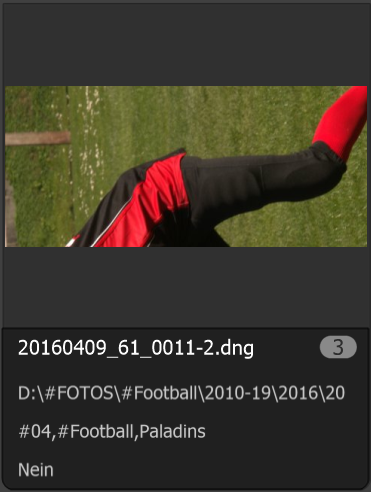

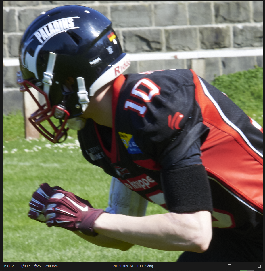

Hi there,
I looks like that photo supreme displays the cropped part of an raw image sometimes wrong.
Please see the included example.
Is this a known bug?
Can I fix this in any way be rebuilding the thumbs again?
Ulrich
Wrong presantation of the cropped part of a photo
- Visualisation of the cropped part of the photo.png (80.24 KiB) Viewed 4027 times
- Correct Thumbnail.png (1.82 MiB) Viewed 4027 times
- Thumbnail Foto in Photo Supreme.png (156.26 KiB) Viewed 4027 times

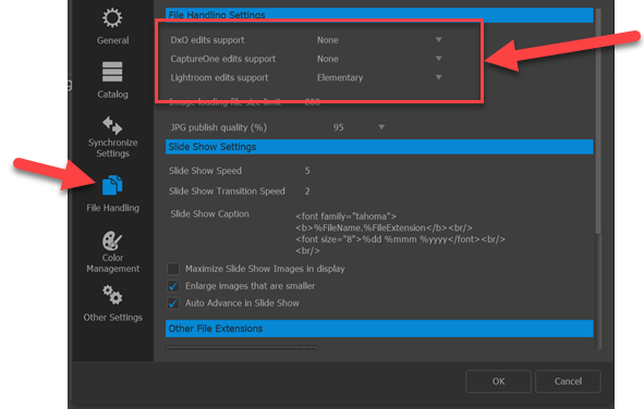

Re: Wrong presantation of the cropped part of a photo
Disable all the editors that you are not using in the Preferences. After that, rebuild the thumb manually with Ctrl+Alt+T (Windows) or Cmd+Opt+T (macOS). You can also disable all editors if that's what you prefer.
Hello Hert,
hmm.
Disabling the Ligtroom support and keeping Capture One active (regardless if option 1 or 2) changes the behaviour to a non croped version of the photo.
Disabling Capture One (then no option is active) leads to the same uncroped looking photo.
So, the choise is the complete wrong cropping with the lightroom setting or a uncropped view with Capture One or none in the settings.
Any clue? This way it's not possible to see how the developed (cature one) photo looks like.
Maybe the problem is, that the photo was first processed in lightroom and now is opened in capture one because I'm not using lightroom any more?
Greetings
Ulrich
hmm.
Greetings
Ulrich
