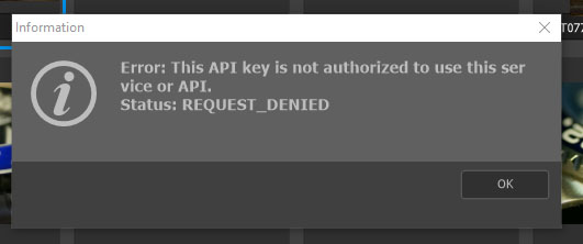

When I try to look up a location using Geo Tag I get the attached error, that reads
"Error: The API key is not authorized to use this service or API. Status: REQUEST_DENIED".
All other functions of google maps seem to be working OK.
Any ideas?

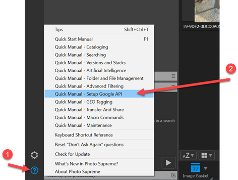

In your Google API Console, make sure that you add at least the following services: Maps Javascript, Maps Elevation, GeoCoding.
Also make sure that you follow the instructions in the Setup Google API manual. Find that in the ? icon in from the left sidebar.
