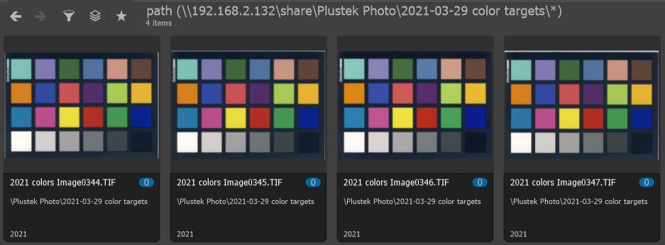

Did a small test to simulate a typical situation.
No metadata was applied beyond what gets automatically created by the scanner. Why are they not similar? I think by all measures they are similar.

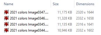

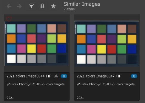

Scanned the same original four times In PSU, the thumbnails look like this Only two were recognized as similar, image 0344 and 0347
- image 0344 and 0347
- color targets 2 similar.JPG (29.65 KiB) Viewed 6604 times

Thank you for sharing the files. The files are not similar because they are too different. The rotation is different, the framing is different. Except from one, they are too different to be considered visually identical.
In other words: use Similar images to find other files of the same photo.like a downsized copy of the same image, or a b/w version of the original). Or a identical visual copy of the original
