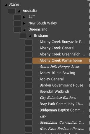

Re: Do not create a label v This label is private
OK. It's just that not all the labels are in italics. The top-level 'Places' is, and some of the sub-labels, but not all.
- Capture.JPG (30.48 KiB) Viewed 7142 times
I guess you've defined those as private catalog labels before making the top level category private.
Right you are sir.
I set the category to public, then reset those labels, then set the category back to private. Now the entire 'Places' tree is italicised.
However, I then added another label under Places and it appeared as non-italicised, even though it is obviously private. Setting 'Places' to public and back to private fixed that so that the entire tree is again italicised.
It's only a cosmetic thing but I mention it anyway.
