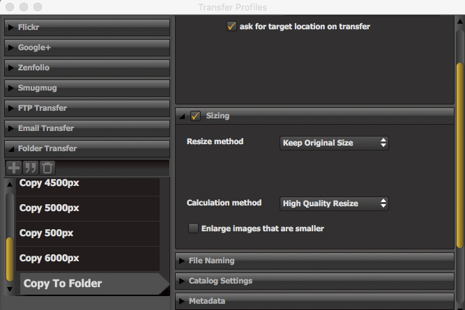

I understand (or thought that I understood) the share function, but this puzzles me.
Using the Share / Copy to Folder function and the settings shown, I'm copying a jpg file to another location. The original is 24.7 MB, but the copy is only 9.1 MB!
Photo SupremeScreenSnapz181.jpg (172.33 KiB) Viewed 8676 times

sizing to original dimensions is not the same as copying the original file. Disable Sizing if you want to copy original file. Some of the sharing option will then not be available.

Does my current setting therefore degrade the quality or what is actually happening here?
Posts: 7947
Re: Do I misunderstand the "Share" command?
The image is loaded the rules of the transfer profile are applied, and then saved..
With JPG there will always be recompression on saving.

I perhaps saved the sizing option a long time ago because I needed some of the other options too, i.e. removing metadata or adding a caption.
Stephen: The original is 24.7 MB, but the copy is only 9.1 MB!
Hert: "With JPG there will always be recompression on saving."
This much? :?
P.S. The term "Keep original size" is also misleading.
Posts: 7947
This much?
Sharing images sends the images with 95% JPG quality setting. Try in any other tool to save the image at 95% and you should get a similar result.
That is what it's doing

Hert wrote: 19 Jun 18 17:14 Disable Sizing if you want to copy original file. Some of the sharing option will then not be available.
Hert, I'm curious about this. Why does "sizing" need to be selected as a pre-requisite for accessing the "Metadata" options?
Posts: 7947
Metadata also allows you to convert colors.
Either way, Sharing is intended for.....sharing :), which typically involves downsizing. The only reason why you can de-activate downsizing is because some people want to share original images.
If you want to remove metadata from your original file, then create a Batch. There you have the option to Remove Exif from a file.
If resizing with the same dimensions is used are the images re-compressed, rather than the files physically copied to a new destination?
Posts: 7947
When Sizing is enabled, the image is loaded, all settings of the sharing profile are applied and then saved with the changes.
If you want to copy files instead of sharing an altered copy then don’t use the sizing option. All profile setting that impact the image file or content will then be disabled in the profile.
