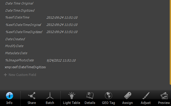

In my case, if I'm looking at the image details panel, the time fields in the Technical section, as well as exif:DateTimeOriginal and exif:DateTimeDigitized inside XMP Advanced, they all show the correct dates! In the Info panel I have also added custom fields for all the Date/Time fields I could find (using the hierarchical macro menus - that's a neat feature, btw!) and I'm attaching a screenshot with those custom fields.
As you could see, Date Time Original (which is defined as: exif:DateTimeOriginal) and Date Time Digitized (that is: exif:DateTimeDigitized) are indeed empty (not sure why), but %exif:DateTimeOriginal and %exif:DateTimeDigitized both have the correct dates. Now, based on the above scheme, shouldn't PSU set the timeline date correctly?

Custom fields for a file which appears cataloged under: 12-30-1899

Robert, thanks for the suggestion. I didn't process the picture in another sw. But even if I did, it shouldn't matter, because the screenshot shows the field values as displayed by PSU itself. My understanding, based on the schema provided by Hert, is that PSU should use %exif:DateTimeOriginal in my case. (And its value appears correct as per what PSU itself shows). Am I wrong?
There is a small detail, however - and it may in fact be significant: the picture is marked as out-of-sync (and so are all my pictures with incorrect dates, I've noticed.) The OOS state is not unexpected or worrying to me, since I intentionally disabled auto-syncing at some point and decided on purpose to manually sync only from time to time. (I still backup my catalog regularly, though.) Nevertheless, based on my own findings and on a previous discussion (in Mantis), I'm becoming more and more convinced that leaving images unsynced not only impacts their metadata state in the physical image (or sidecar) files, but also the internal state of various metadata in the PSU database. I don't have any other explanation for the incorrect dates in my case.
