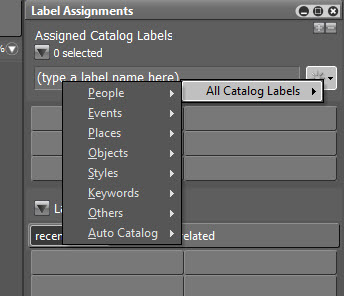

I already have an appropriate label somewhere in the Events hierarchy
I have "endlessly" lobbied Hert to allow a catalog label tree 'browser' in the LAP - Like in V5 - so that I can find the label in the Tree without having to flip between catalog folder - catalog labels - catalog folder - catalog labels..... I also often find myself unsure if I have a existing label already - or must I create a new one. And If I create a new one I want to match the existing pattern - so to be able to look and browse up and down the catalog label tree is vital.
I just don't know exactly how I would define the feature
- Just like in V5 - but Supremely Better :-)
18-10-2012 11-23-21 AM.jpg (26.59 KiB) Viewed 13487 times
Typing in the name to search for a label is laborious as it seems to list all sorts of options before it finally shortens the list to just the few I want to see. And its really really Slow to start.
I really miss the "Copy Label Assignments from this image to that Image via the clipboard" (Ctrl- Shift C) feature - its just cumbersome at the moment to click on the Source and destination thumbs - see the brown labels - click each label to go Green - label by label - it was must faster in V5.
I loved the ability to create a hierarchy of catalog labels "on the fly" - eg typing Events::Birthdays::2012::My Birthday to create the My Birthday event - rather than scrolling up and down the tree (that is initially displayed so small) - but I fully understand that that may be a 1 user request !
hide the explorer panel
- Ctrl - M works quite well for this use - even though it doesn't just drop the Left Tree Panel but other screen elements too.
