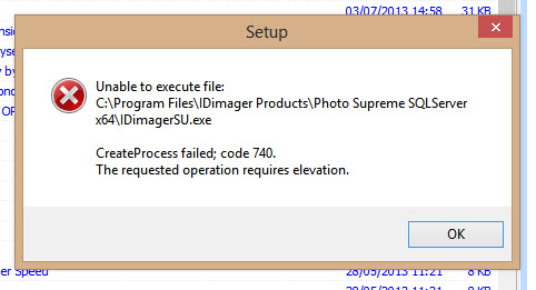

1. When I ran the setup straight from the download and at the end selected to Run Supreme I had a UAC error.
26-08-2013 08-11-01.jpg (45.5 KiB) Viewed 14036 times
When I then ran with Admin Permissions from the start menu all was well.
