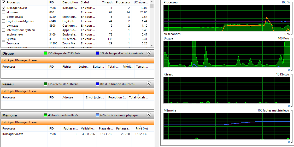

I've also just been running the 24K image test with the resource monitor running. As in the screenshot below, the CPU, hard drive and memory are a long way from being maxed out. The orange line shows when PSU was opening the 24K image folder and, except for a blip, no more than 25% of CPU capacity is being used, while the the SSD is little changed from when the machine is idling. The network (and virus scanner) are switched off.

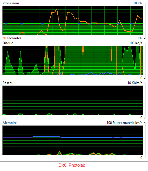

This doesn't seem to be caused by any throttling on the machine. By way of comparison, I've also taken a screenshot of the monitor while running DxO PhotoLab, which is making much more use of resources (the orange line being DxO):
Is there some way of making PSU more aggressive?

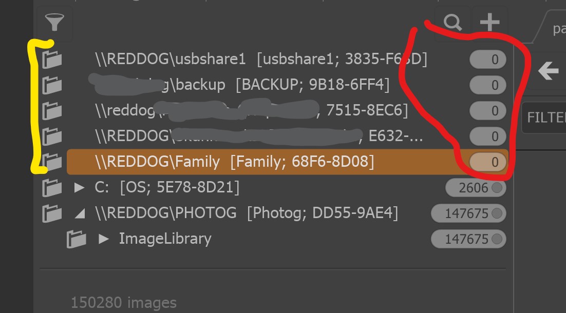

I have this happening to me, too. In my case, they keep reappearing. Confirmed still exists in 3765.G8DHE wrote: 30 Jun 21 15:01 One oddity has shown up its identified all the other drives on my \\SERVER without me doing anything only the \\SERVER\PICS was previously selected ?
\Media, \Web etc were not included, I'll try removing them see if they stay removed ?
Edit: Removing them seems to have worked and they haven't reappeared after closing and restarting.
Tried the following without success...
Rt. Click > Remove
Catalog > Compact current Catalog
Reboot

Yes it happened again to me this morning another drive popped up out of the blue again a drive that has never been connected with PSU at all (Email) and again on a share from the local server as were all the previous ones ...... it seems to be mistaking these drives for others perhaps ?
Re: New update: 6.3.0.3755
By accident, I figured out the repeatable trigger to the re-appearance of local or attached phantom locations. I see thm come back if I use PS to move local folders.

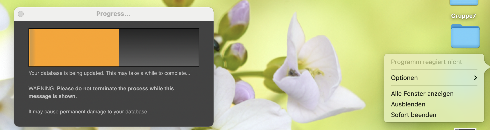

The new versions crashes when updating the database, where do I find older versions to download? And what was the last version with the old database system?

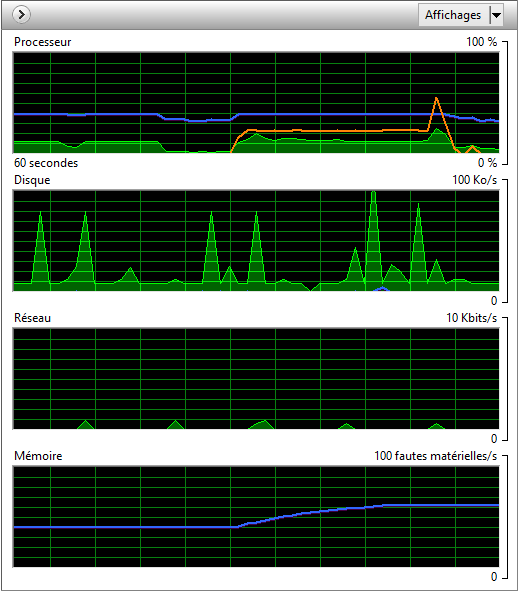

That certainly sounded plausible, but turns out not to be the cause. I imported 12K images into a new catalog overnight; switching from displaying 1 image to all 12K takes around 18 seconds, and the resource usage profile (below) looks similar to the original catalog - the orange line is PSU.Hert wrote: 01 Jul 21 17:52 Another thing that could be the case is that your catalog is not in good order (mainly: missing indexes).
Starting with a new catalog file and importing your 24K images will be faster and easier.
Checking the spec for the processor, I see that it has 2 physical cores, each running two threads to provide 4 logical cores. Leaving aside the blip in processor usage as the end, the CPU was again running at between 23 and 25% - so I'm guessing that only 1 of these logical cores is being used. If it was possible to split the processing over more cores, that would presumably have the potential to cut processing time significantly - but maybe it's not divisible?

Please upgrade to build 3768.jtk wrote: 05 Jul 21 4:46 The new versions crashes when updating the database, where do I find older versions to download? And what was the last version with the old database system?

Only the latest version is available.jtk wrote: 05 Jul 21 7:37 Bildschirmfoto 2021-07-05 um 09.33.35.pngI downloaded the newest version from the main internet page, it still happens.
I want to go back to a earlier version to save the database and compact it again.
Please send a message for assistance with a failing database upgrade.
https://www.idimager.com/contact-us
