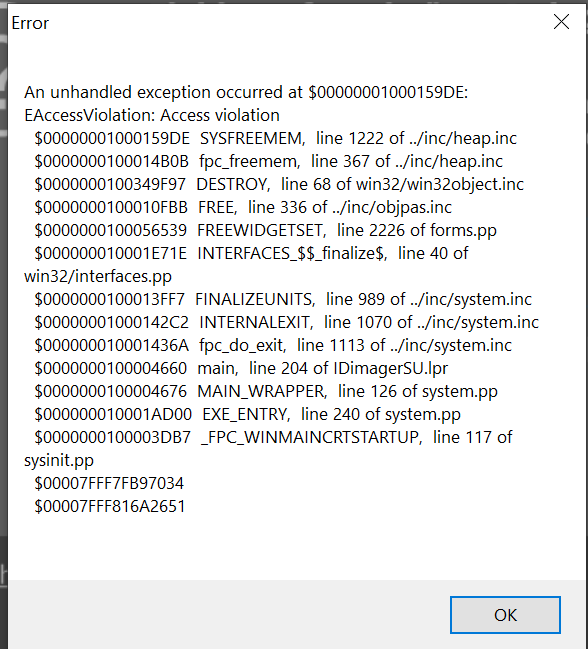

I just created a new catalog. And then tried to exit PSu. Instead, I got an exception.
So I killed PSu, restarted, opened the new, empty catalog, created another new one. And the same thing happened.

Well, back to verifying folders, and another poof crash. This one came with an exception report. Although unfortunately this looks like an after-effect of the crash rather than the cause. Looks like maybe heap corruption?
- Capture.PNG (35.98 KiB) Viewed 7366 times
