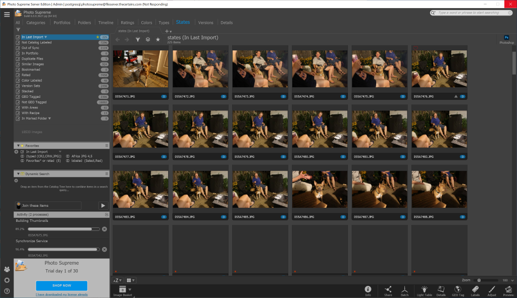

I've been a Photo Supreme user since V3. I keep paying my $150 every 18 months to upgrade, but I'm just tired of the "Application Not Responding" constant problems I have. I get them all the time when trying to import even a few hundred photos. So I thought, "OK, I'll give V6 a shot. Maybe things will actually be different."
But no, I just downloaded V6, tried to import some images, and when I click on the little drop-downs at the top, all that happens is that the window bar grays out. Then I tried moving my window from one screen to the other and I got an exception (which I sent along).
Restarted. Got the import running. Now this. It's not responding and both the Synchronize Service and Building Thumbnails bars are frozen. It's ~500 images.
Restarted. Started another import. Came down to check on it and PSU had crashed/exited. Just not running any longer - no record of what happened. I really like the promise of PSu. I picked it when iView went under because of the promise of PSu, that it works on Mac/Windows, that it's open, etc. But I spend as much of my time trying to work around problems as getting work done. It's just so frustrating.
Am I really the only person constantly getting crashes and freezes?

V6 is very solid, especially the PostgreSQL version that you're using. Most likely you have an image that somehow chocked PSU.
Try to narrow the set down.
Select half of the set, press Ctrl+Alt+S to manually read metadata, press CTrl+Alt+T to manually update thumbs
Then repeat for the other half.
Is there a half set that stalls, then slide and dice that set further until you found the image (or images) that brings PSU to its knees.
Once you found a file, then please send me a copy.
tia

Did you do the test I asked you to do?
In your screenshot you have a set of about 250 images. Slice and dice to find a possible culprit file should not take long.

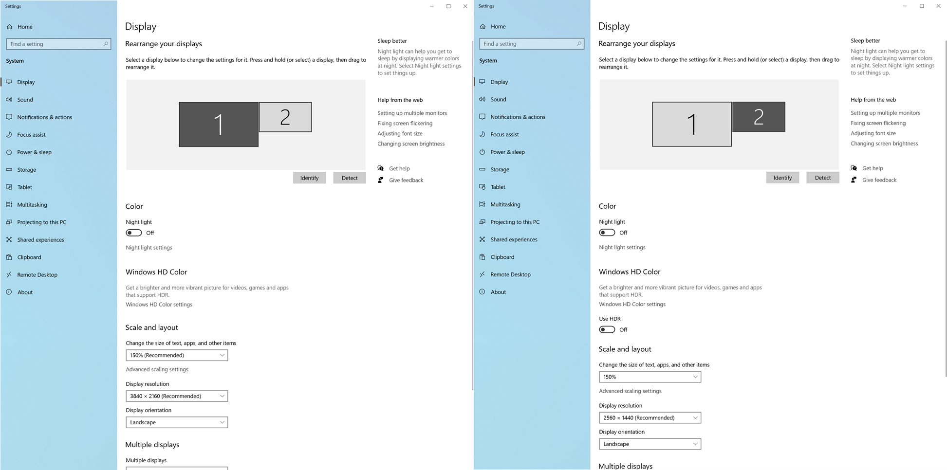

I just tried it here with dual monitors, both running at different resolution, both running with scaling enabled (first is a 4K monitor, second is a 2K monitor). No issues with positioning the drop downs that you mention when PSU is dragged to the second monitor
Below are my display settings of both monitors (latest Windows 10 version 10.0.19042.867). Maybe you can also show your display settings. And check if perhaps your video drivers are giving you issues.

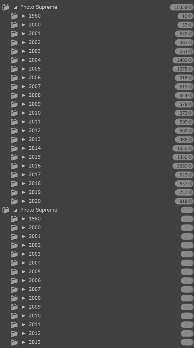

OK. I will start that process. May take a while, since for the first few rounds I'll probably do them overnight. There's another issue in that PSu shows my root folder twice, but one doesn't show any image totals. They are exactly the same path when you hover over them
[ external image ]
I'm afraid to remove the second one as I don't want to have it just remove everything in my database, but it's at the least annoying to have them both there and at worst indicative of something wrong in my database (could this be the source of the crashes?).

[ external image ]

Re: Poof crashes / instability
Don't do it with your entire catalog. Find a small set that gives you issues (like the one you showed in the screenshot of a few hundred). Then do the slice and dice. Shouldn't take long to do that on such a small set.acertain wrote: 24 Mar 21 5:44 OK. I will start that process. May take a while, since for the first few rounds I'll probably do them overnight.
If you're afraid to remove the second then make sure you have a backup of the cat.db file so you can always revert if needed.I'm afraid to remove the second one as I don't want to have it just remove everything in my database, but it's at the least annoying to have them both there and at worst indicative of something wrong in my database (could this be the source of the crashes?).
To resolve this; right click on one of the two top level folders and untick the "Make this the root folder". Is there still a duplicate? In that case right click on the top level folder and select "Map to the correct physical path". Repeat that for the duplicate.
If things don't work out then restore the backup

OK. I unchecked them and one was mapped to \\server\path and the other \\server.domain\path. So they were both pointing to the same thing, but also separate. When I split them out, they had different counts of photos. One only had a few hundred, so I just deleted those and am now doing a verify to bring them back in. The previous verify did die somewhere around where these two paths both had sub-folders in common, so maybe that's the problem.
