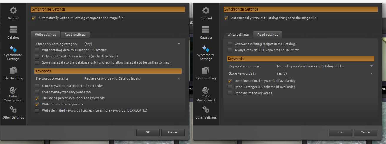

I will add my voice to Mike's and Tom's suggestions to share with us your synchronize settings (preferably by attaching two different screenshots with your Write and Read settings). As much as we'd like, it's hard to help without that info (although Tom's suggestion might be all you really need, with a bit of luck). Describing your issues in a single phrase over many lines doesn't help following them either :-)

Well Tom apparently got part of it. I changed my Keywords processing setting to "Replace keywords with Catalog labels" and now most of the changes I make in PSU are reflected in other programs when I save in PSU but strangely not all, i tried a file and one keyword was still left behind even though the others were removed... I haven't a clue as to why.
Anyway, as for the screenshot request that is more than fair with all the begging for help I have done!
Any other settings I have that seem "off" please do let me know.

I'm going to go beyond vlad's request for a better understanding of the hierarchy pertaining to the stubborn keyword that is not being removed. Instead, I'm going to ask why you feel it's advantageous to write all parent labels as keywords. You're already writing them as Lightroom hierarchical keywords, so there is no benefit to also writing them to the Keywords metadata field. I recommend that you not include the parent labels as keywords.
On a separate subject, I see that you have disabled writing the catalog data to the IDimager ICS scheme. Assume everything that could possibly go wrong does go wrong including all backup files of your catalog becoming corrupt. If you enable that setting and synch all of your files including those that show they are in synch as a first-time effort, you will be able to automatically recreate your entire catalog including the IDimager proprietary information such as version sets, bookmarks, private catalog labels, portfolios and the like. Once you have completed that first-time synch, you won't need to synch the files again that appear to be in synch.

@Mike. To be honest I did not know I had half of those settings set, I didn't really tamper much with the settings (though if these weren't the defaults then I guess it was me :? ). I'll try going with your suggestions as I didn't even know what the "writing the catalog data to the IDimager ICS scheme" was, as for the hierarchical keywords, this is on the edge of my understanding. For me a huge issue is compatibility, I didn't notice I had Lightroom hierarchical keywords set but I prefer to go with whichever is more universally used by other programs. When I search, say in another program I would like to be able to (going with location) specify Europe, or Italy or everything with Europe but not Italy etc, I know simple keywords can make that possible in many programs, are Lightroom hierarchical keywords as standard as regular keywords?
