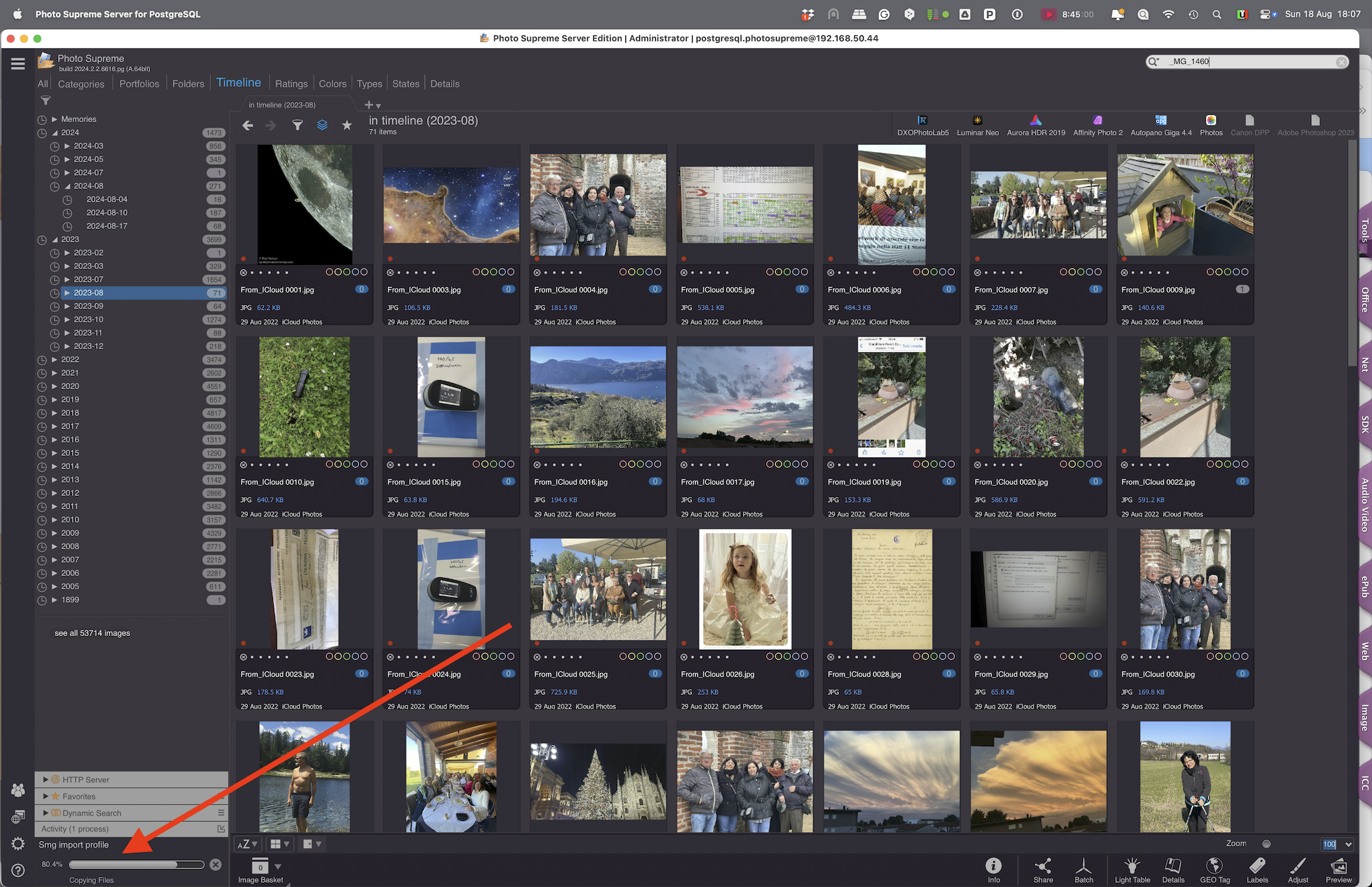

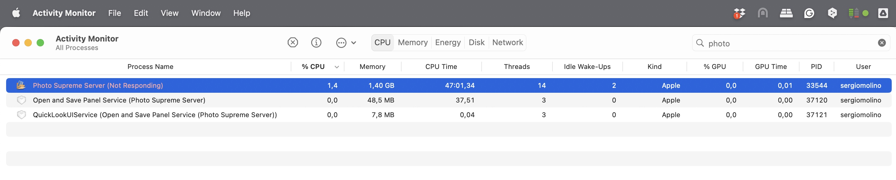

I started an import of images and then I searched for an image, then a PSU hung and appeared as Not Responding app in the Activity Monitor.
How is it possible to understand if it is waiting from the DB server (which is on the NAS server) or is completely hung ?
Is always safe to kill it?
I am using the last version of PSU, on Mac M2 machine
It's about 30 minutes that is running without updating the process cursor, see image.
May be very useful to have a way to understand what is doing in any case...

The best way to check this is look into logfiles and show pg_top on your serversmgaetano wrote: 18 Aug 24 16:15 How is it possible to understand if it is waiting from the DB server (which is on the NAS server) or is completely hung ?
Not the best solution. Separate server is always better.
PSU uses in your case - relational database (postgreSQL) which has "rollback" function all operations that has been not committed
Not responding is not responding - kill your process. Possible you have wait 5 minutes because your license is locked.
