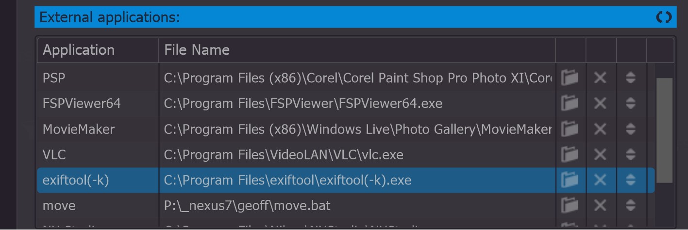

Why not call EXIF from within PSU with the required command line ?
This will then pass all the file names and the defined command to EXIF as an external application, once EXIF has finished then you can re-sync the images selected within PSU. I have the default(-k) set up but it can be changed as needed;

Thank you for the suggestion, I have to find how to add exiftool ( a perl script) to the PtotoSupreme external applications (I am using a MacBookPro) and how to pass arguments from PhotoSupreme.

My computer is a MacBookPro and there is unfortunately no executable version of exiftool for OSX, only a command line version. The executable version exists only for Windows.

Re: Redating from file name
AlainB wrote: 28 Feb 24 13:43 G8DHE suggestion was for Window.
No, his suggestion was OS Independent. You can put in this menu each App is OS executable.
