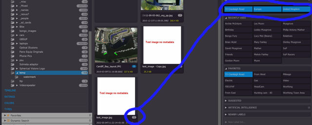

On the image below there 4 images on the left, (and one folder) the selected image has 3 Labels and the three labels are shown on the right panel.
Screenshot 2023-03-31 220043.JPG (29.01 KiB) Viewed 10977 times

Thanks everybody - I'm afraid I can't quite make out the detail in the image you posted, G8DHE, but it _seems_ that your parent is still 1 below category level.
