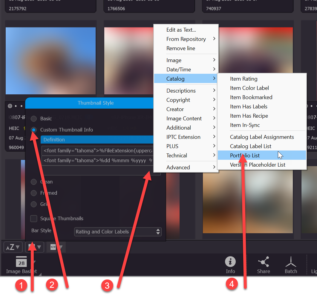

Enable custom thumb info
For a new line, select the drop down-> Catalog -> Portfolio List

Could you give directions how to do that in detail? I tried it but got lost.

Great, Hert. There is always a way, right?
I've made the change according to the instructions below (added for user Alfons). This doesn't address the ease of adding and removing collections. It would be helpful to provide an interface to click on multiple collections, rather than add/remove them one-by-one.
At the bottom of the file window, click the middle icon called "thumbnail style...". Mine is set to "Custom Thumbnail Info. There is a blank new line below the current info. Click the down arrow and choose "Catalog -> Portfolio List".

Alfons wrote: 05 Mar 23 11:16 Could you give directions how to do that in detail? I tried it but got lost.
Did you never use custom thumb lines before?
Here's how
