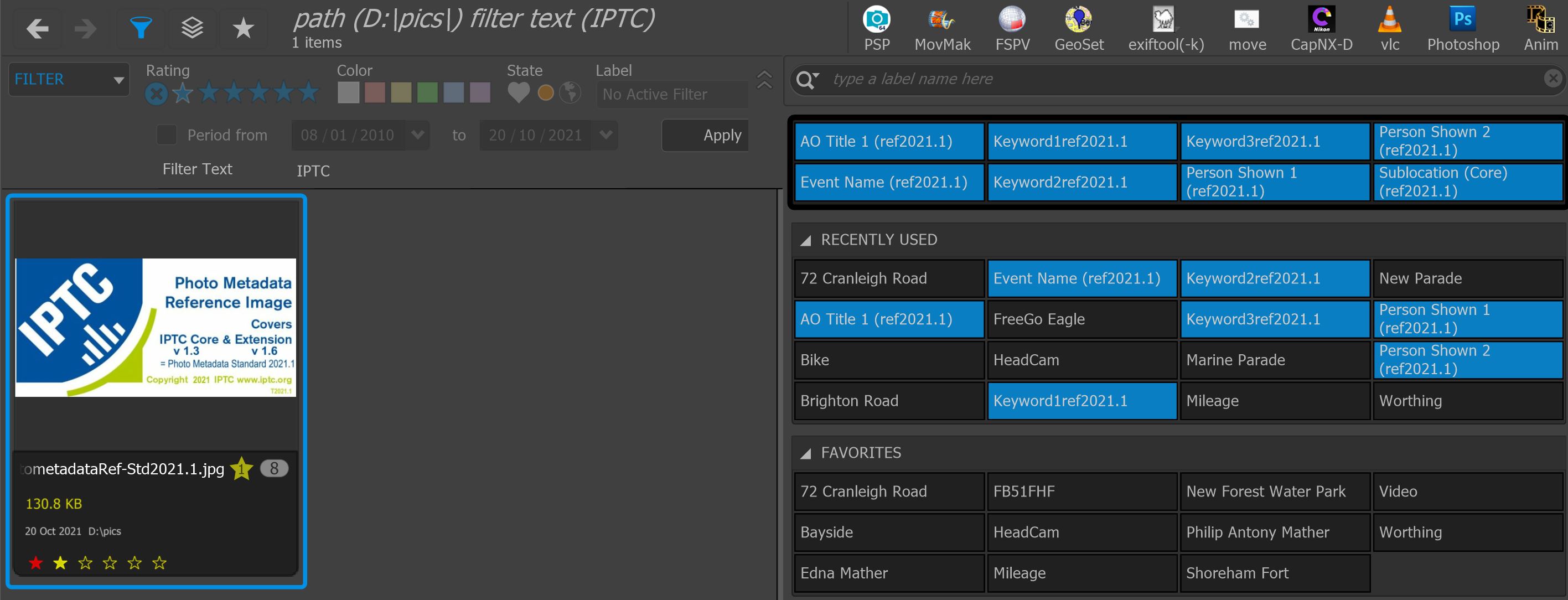

PSU will certainly load IPTC metadata into the relevant fields try downloading this file from the IPTC site https://iptc.org/std/photometadata/exam ... 2021.1.jpg
It contains descriptive data about each field which if you Import it into PSU will display them
It will automatically put the Object/People/Event/Location information into the relevant PSU categories, the others are placed in Miscellaneous from where they can be Drag&Dropped into the relevant areas.

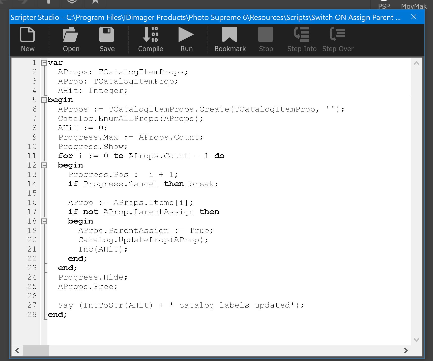

One question about import; if I import photos containing a Countrty-State-City-Location hierarchy is it possible to have this metadata populate the labels seen with the labels panel. Currently I only get a label for the location after import.
Re: "Auto" creation of catagory and collection names?
Yes, by default only the lowest level of the hierarchy is identified, I turn on the option either manually or use the provided script to alter the setting
scripter_assign ON.JPG (228.93 KiB) Viewed 5334 times
JeffK
Posts: 33
Joined: 10 Jan 16 6:50
Post by JeffK »
G8DHE wrote: 28 Jan 22 9:42 Yes, by default only the lowest level of the hierarchy is identified, I turn on the option either manually or use the provided script to alter the setting
Thank you. And then reimport the images?

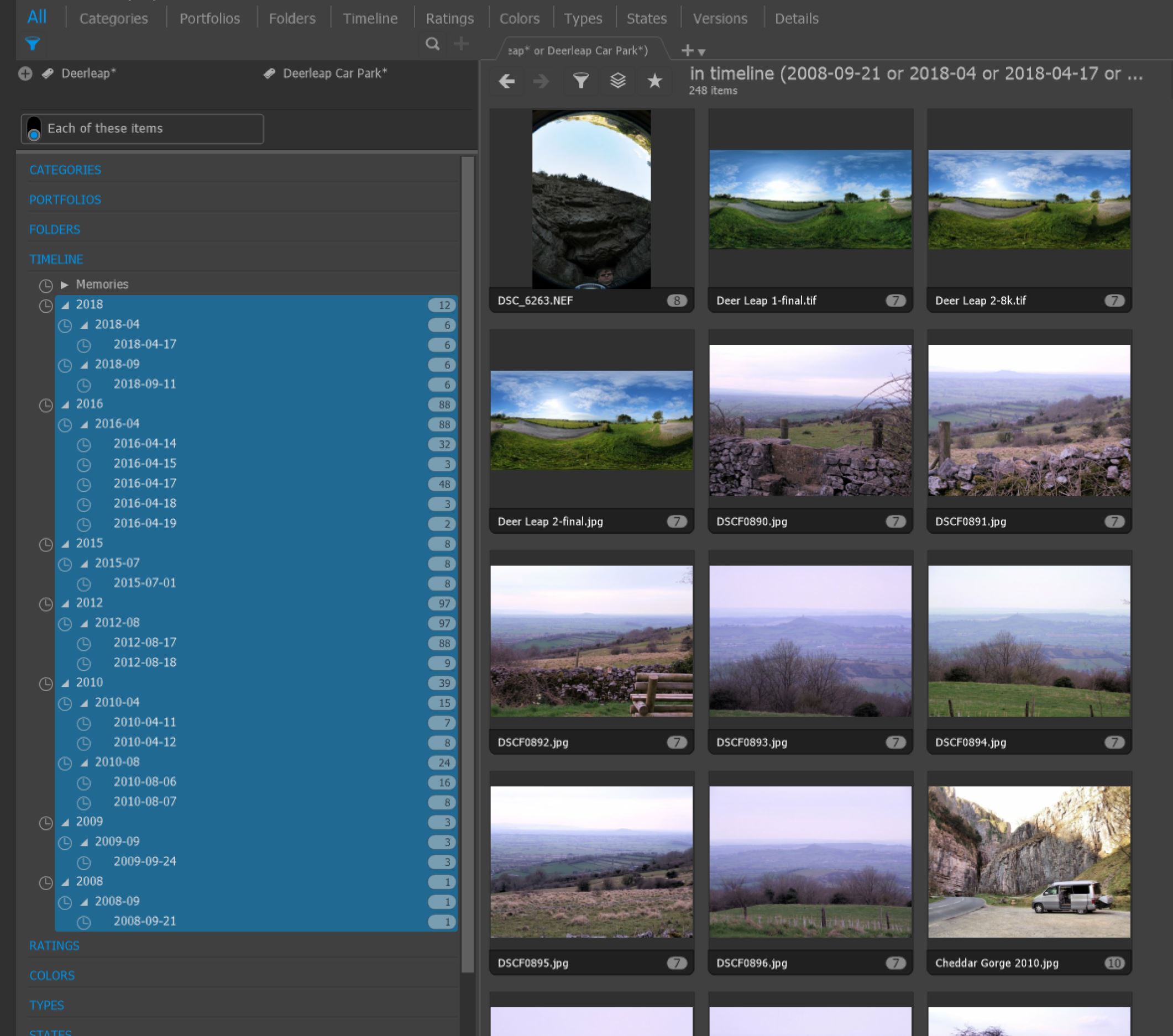

Re: "Auto" creation of category and collection names?
No the data in Categories can actually be anything you like over and above what is already provided.
What isn't clear is what sort of hierachy are you trying to create ? Initially you spoke about a "Location" called "Deer Creek" provided it was correctly stored in the IPTC information along with the Town and higher levels of the Places hierachy then it ought to have been correctly placed, if anything was missing then it usually ends up in Miscellaneous where it can be dragged to the correct part of the structure, once its in the system then any other identical location will be added to those labels as well. The same applies to any other part of a Category structure, once it has been defined once then provided all the parts of the structure are there then another image will be added to those labels, if any part of the metadata structure is missing in the image then PSU can't be certain where it should be placed so it will end up in Miscellaneous again.
An example of the problems that can occur is a location I have called "Deerleap" which is an area on a hillside with a carpark, now Google will pickup varying Town information when using GEOReverse lookup depending where on the site the shot was taken, some times it picks up the name of a small village, other times it picks up the name of one or other of the nearest Towns hence sometimes the location info needs correcting to match my preferred naming convention!
One item you mentioned later was a Date and Location structure, I would use the "Timeline" option and combine that with the "Places" info not in a new structure but by dragging a relevant label like the Town to the "Filter the catalogue " (top left filter symbol) then click on the "Timeline" then I would see all the shots I've taken over the years from that location ordered in the Timeline view.
For instance using the above "Deerleap" example, I have dragged the two locations (haven't sorted some items out yet!) "ORed" them and then clicked on Timeline and the result is below;
Using Catalog filter etc.JPG (338.25 KiB) Viewed 5285 times

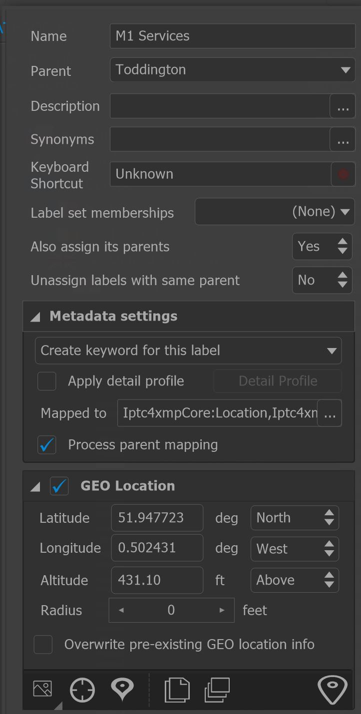

The date and location structure was just an example. I can't get past how I create a hierarchy level from any given IPTC metadata. Do I use the label details dialog, the category level dialog or what. I'm missing something really pivotal. Let's say I want to include lens zoom or camera aperture in my hierarchy. If I find the relevant IPTC metadata field then what next?
I got the Deer Creek one sorted because it was part of the inbuilt translation provided. But what if it wasn't. What about metadata that is not included. How do I turn that into a list of values in the catalog pane. I keep on getting a static one entry field there.
