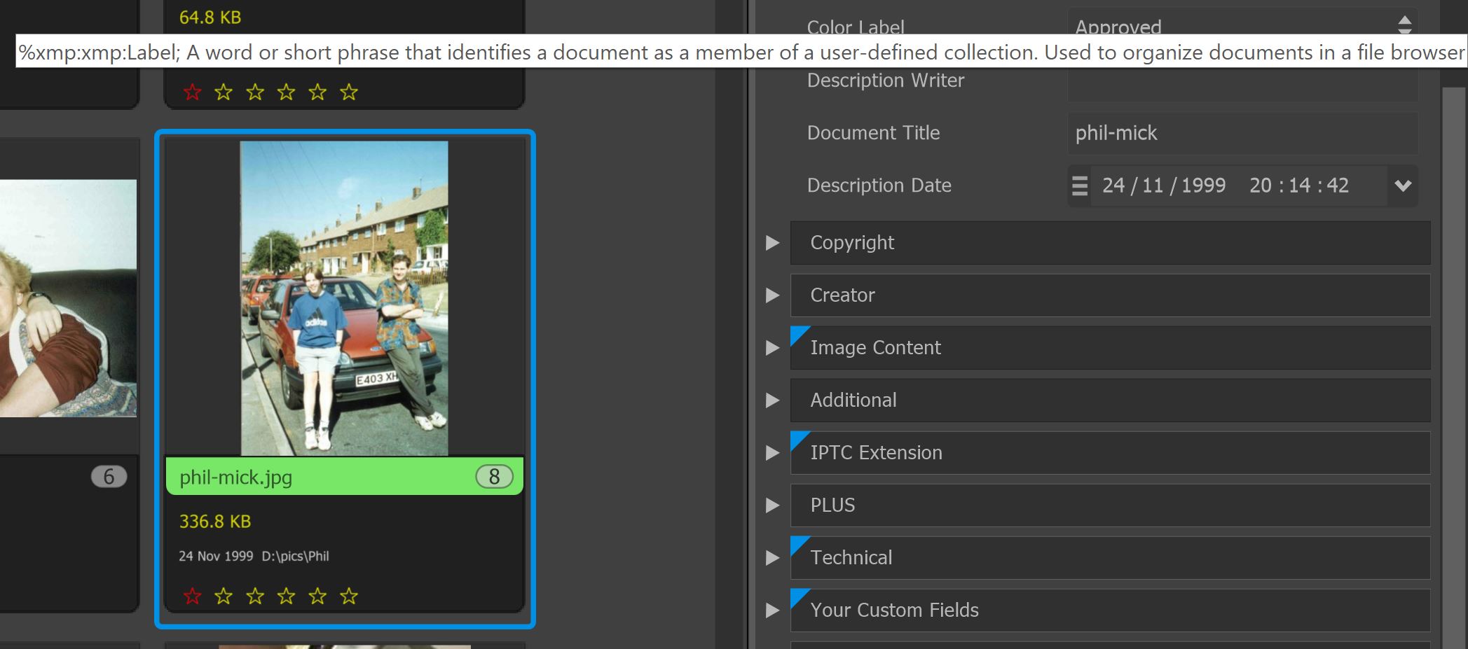

Is it not simply %xmp:xmp:Label as can be seen below by examining the field description of an image with the label set ?

yes, this is the necessary field, but how can you read and write this field via script ??
