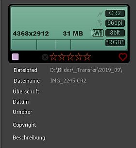

After the last update (5.0.0.2426, standalone, W10) file metadata isn't displayed completely and partly wrong. Camera and lens information (EXIF) are missing completely, Author/Copyright is displayed in non-Raw versions only. File size is displayed incorrectly for CR2 files.

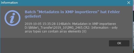

Thank you for your reply. I tried that but got an error message box (screenshot attached). Basically, I didn't have any problems so far, and I don't have a new camera oder different file types in use; so why would the application behave differently all of sudden? Just a thought: Could it be somme kind of file access (read/write) phenomenon? That could also be the case for my other problem posted in the forum (viewtopic.php?f=57&t=27785&p=123031#p123031).
- PhotoSupreme_Error_XMP_191005.JPG (20.01 KiB) Viewed 9289 times
Re: Wrong/incomplete file metadata displayed
That error means that psu found incorrect formatted XMP. Try to delete the XMP sidecar for that file (make a backup of the file if you think needed)

Update

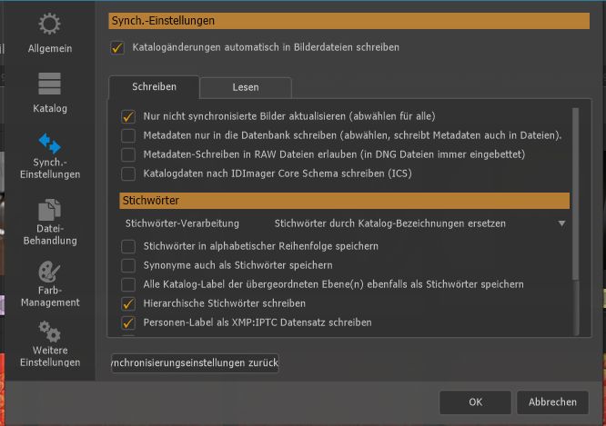

After unfortunately having been too busy with other things, I’ve now returned to my still existing PSU problem. I hope a couple of new observations might shed a different or at least slightly brighter light at things... As to your question, I think I don't use embedded metadata, but have attached my sync settings so that you can see for yourself. Suggestions for a useful setup always welcome !
Now for my current observations:
1. PSU is not able to export affected files using a batch process. I attach the resulting error message.
2. When I copied a „good“ file to a „bad“ directory using PSU’s copy/paste functions, syncing for this file still was doing. So one image was OK, the next one in this directory (even by the image number) not. -- I extracted the neighbouring files‘ EXIF information (with a different tool, IrfanView) and saved them to an Excel file which I can provide. I couldn’t find any hint about changed entries, though.
3. Copying a file directly from the camera, thereby avoiding Canon’s EOS Utility, didn’t lead to a different result.
4. On the other hand, newly shot CR2s with another, older, camera in a different directory are handled without problems. This shows newer images still can be managed and „understood“ by PSU, therefore indicating there’s no general problem with files after a specific point of time. (I didn’t import them with a Canon tool, but by transferring the files using Windows Explorer.)
5. Files from our latest camera, M50, in Canon‘s CR3 format aren’t synced and properly read either.
6. The incapability of reading EXIF information applies to TIFFs „developed“ from the raw files also.
7. I compared security settings for both the images and the directroies they’re in from before and after the behavioural change, bit couldn’t find any hint about different settings (caused maybe by Windows or Canon software updates).
8. My current (humble) idea ist that PSU rather doesn’t write XMP files because it cannot extract information from the images in the first place, instead of not having writing permission for the directoy.
There are no problems whatsoever opening and editing the images in DxO Photo Lab and Affinity Photo. Metadata is shown properly.
- PSU_Sync_Settings_200405.jpg (43.72 KiB) Viewed 8732 times

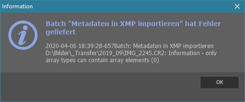

No, unfortunately this also failed. (Error message attached.) I also tried "store metadata to file", but PSU doesn't succeed; the progress is not progressing at all, but remaining at 0,0%.
Can you upload your XMP file and share a link (here or by email). What software do you expect that wrote the XMP?
The error message that you displayed *always* means that your XMP contains entries that do not comply with the XML/RDF (the format for XMP) rules. That’s why I asked for a sample file.
Please provide a sample first. You can share it here or send it to support@idimager.com
