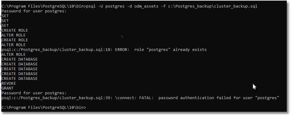

1) On MacPro, I backed up complete catalog using command: pg_dumpall> /postgres_Backup/cluster_backup.sql
2) On VMs running windows, I installed Postgresql 10.8.
Modified both config files as stated in instructions.
3) Installed PSU with which I created new catalog. Named it same name as migrating database.
4) Ran Restore command: psql -U {username} -d {db name} -f cluster_backup.sql
System returned error: cannot find {db name}, (I had put my database name)
5) Went back to step 2. Didn't reinstall PSU.
In Postgres, I created a new catalog same name as the migrating catalog

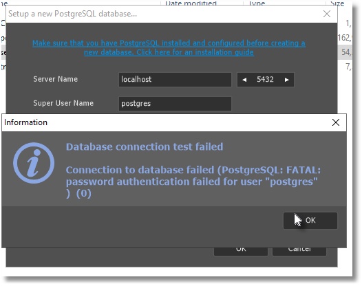

6) Installed PSU. and tried connecting to existing catalog: Failure see attached file
once operation done, it asked for postgres password again. any password I tried wasn't accepted.
Will keep trying tomorrow.

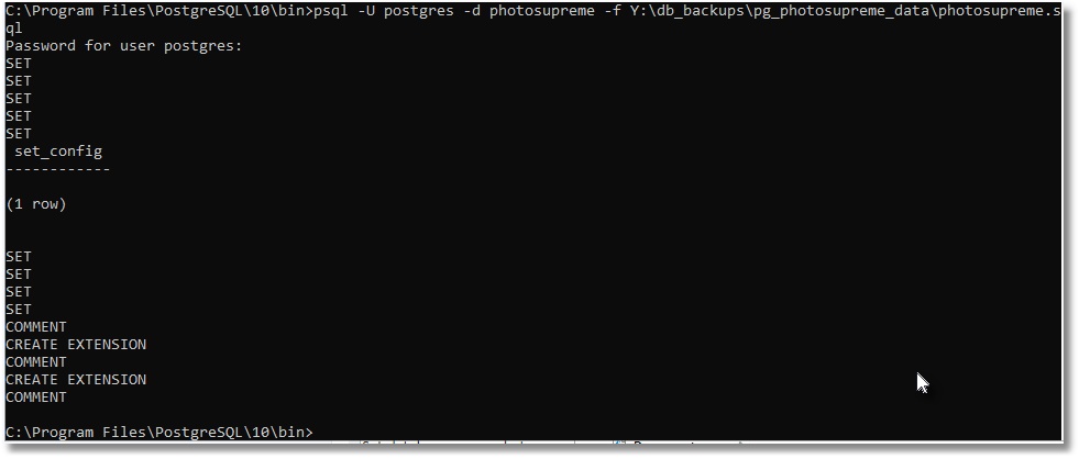

This is how I proceeded based on my understanding of proposed method.
1- I backup up database with following command:
pg_dump -U {user-name} {source_db} -f {dumpfilename.sql}
pg_dump -U postgres photosupreme -f photosupreme.sql
I suppose this backed up photosupreme and photosupreme_thumbs database as suggested.
2. On new machine, I install a new PSU database
Set database name: photosupreme
3. Restored photosupreme database using following command
psql -U {user-name} -d {desintation_db}-f {dumpfilename.sql}
psql -U postgres -d photosupreme -f Y:\db_backups\pg_photosupreme_data\photosupreme.sql
The result shows in restoring 01 file
Looked good.

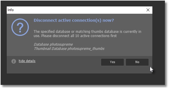

Launched PSU.
was asked postgres superuser password.

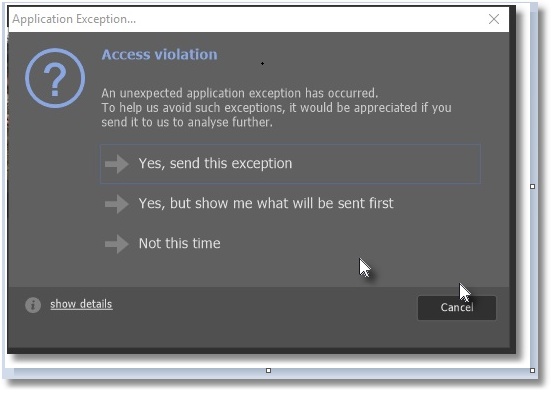

Then message in restoring 02 file
Didn't know what to answer: choose yes
Then message in restoring 03 file

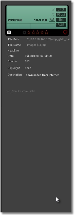

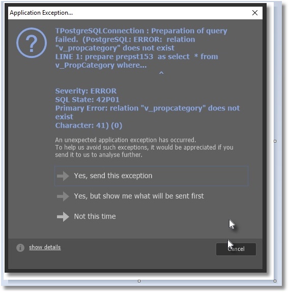

Once in PSU, nothing showed as having been updated.
I thought I may need to upload assets.
So I did.

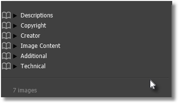

All categories were present. I assume because of assets metadata.
There were missing info in the info pane, in details pane and all mapped info in categories are also missing.
See other attached jpgs.
Will keep experimenting.
So I did.

Re: Catalog Migration
Your message indicates that you have missing views. Make sure that your backup is complete.
