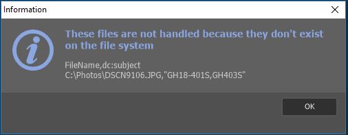

I need to import 1000s of photos and assign some basic info as keywords from a related text file. To do this, I'm using the "Run Script from Repository>Catalog>Read Metadata for Files in Text file" option when I right click on a photo. When I run this however, I get this error: "These files are not handled because they don't exist on the system".

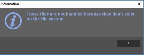

To try and troubleshoot this, I imported a single photo into PS, assigned two keywords, then exported the metadata to a CSV file. Then I deleted the keywords from the the photo in PS. Now I have a photo in the catalog without any keywords. I should be able to run this tool using the exported CSV file and assign the labels, correct? Curiously, when I use the PS-generated file (Test1) I get a slightly different error than when I use one I generated manually (Test2). I've looked through the forums and tried all sorts of variations (quotes/no quotes, semi-colons) that were suggested but none of them seem to work. What am I getting wrong? Is it the syntax?

Did you select the option in that script that that the first line contains the field names? And sis you select the connect field separator? I just ran the script with both your attached files and didn't get an error

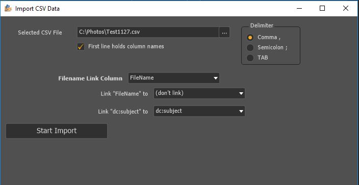

I only get the error when I try the "Run Script from Repository..." off the context menu. When I use the scripter (Tools>Scripter) and run the https://repository.idimager.com/openres ... D96EA3BFD6 script, I can see the file being processed in the activity window but ultimately the photo has zero labels associated with it. I made sure that the first line box was checked, and that the delimiter was set to comma. Again, it doesn't throw an error when I run it this way, but the labels I'm trying to assign don't get added to the photo metadata. Not sure what I'm doing wrong.

I now see the confusion; The script "Read metadata in Text Files" takes a list of file names from a text file and reads the metadata for those files to the catalog (same as right click -> Metadata -> Read metadata from file" for a list of files).
The "Import from CSV" script is not in the context menu and only available from the repository site.
I've just updated the script so that you can also use it to import keywords as dc:subject

Thanks Hert. I downloaded the new script and the import/assigning labels function is working. My only issue now is that the imported labels are being added as new labels under 'Miscellaneous' even though they exist elsewhere in the catalog hierarchy. When I use the context menu to assign comma separated labels (Run Script...>Catalog>Assign Comma...) it automatically assigns them to the existing label without creating a new one under miscellaneous.
