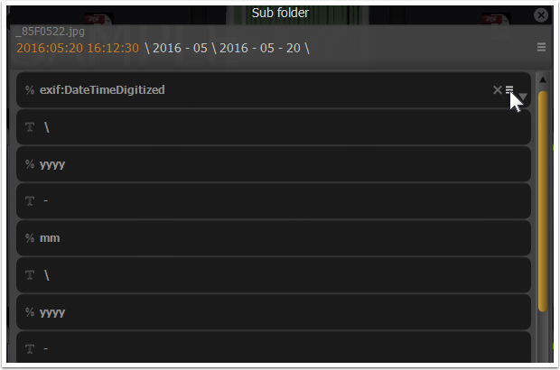

Closely related, I was already trying to use the DateTimeDigitized feild (it *looks* like PS kinda does what I was refering to above and uses available metadata, starting with DateTimeDigitized?) and I tried:
To start off I tried going to import and specifying (using the convient pull down menus)
%exif:DateTimeDigitized \ %yyyy - %mm \ %yyyy - %mm - %dd \
But every time I do it gives me the following (format) output
YYYY-mm\filename
I don't understand since in the little "preview" it shows
2004:02:07 02:38:19\2004-02\2004-02-07\
The obvious problem would be that ":" are not allowed in win file names but I had assumed that PS would put in something else like an "_"?
What am I doing wrong and/or how do I get it to express the DateTimeDigitized with out the ":"

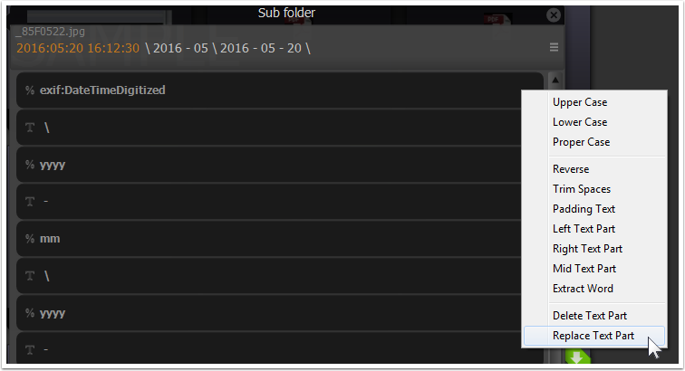

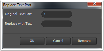

I might be able to answer a portion of your question.
You can use the Replace macro to replace the ":" with the "_".

However, this may work. If your click around - maybe the down arrow on the field or the Text button, you want to enter the following:
%exif:DateTimeDigitized{replace=:,_}

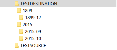

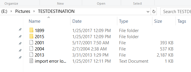

The test folder has 900+ files, mostly JPG but some TIFF. When I click on the "select by date" drop down menu it shows many different dates so PS is seeing the dates of the files (maybe not the EXIF/IPTC/GPS? but it worked once?) attached is a screen shot.
... Problem is, its still only importing 3 files?! The file name rename part is working perfectly for those 3 files and the (sub)folder creation/placement is also working well but again, only for those three files, I have tried comparing the metadata of those files to the others and there doesn't seem to be anything special about those files compared to the others (all the metadata is kinda messy, hence my wanting to come up with something that would use EXIF or IPTC or GPS).

Well... I am back. It is apparently not quite as easy as I thought to take what was working for the file name and apply that to (sub)folders.
What I am trying now is a regular name but folder and sub folders based on either the EXIF/IPTC/GPS dates, this is what I tried:
%EXIFExists%/EXIFExists%exif:DateTimeDigitized{dateformat=yyyy}\%NotEXIFExists%/NotEXIFExists%IPTCExists%/IPTCExists%iptc:DateCreated{dateformat=yyyy}\%NotIPTCExists%/NotIPTCExists%GPSExists%/GPSExists%gps:GPSDateStamp{dateformat=yyyy}\%/NotGPSExists\%EXIFExists%/EXIFExists%exif:DateTimeDigitized{dateformat=yyyy-mm}\%NotEXIFExists%/NotEXIFExists%IPTCExists%/IPTCExists%iptc:DateCreated{dateformat=yyyy-mm}\%NotIPTCExists%/NotIPTCExists%GPSExists%/GPSExists%gps:GPSDateStamp{dateformat=yyyy-mm}\%/NotGPSExists
It kind of worked, some files were neatly moved to a sub folder in the format of \yyyy\yyyy-mm\ but others I am not quite sure what happened, it looks like some image files were renamed to years (not put in sub folders), below is from fileexplorer I did get an error:
"Copy failed for E:\Pictures\TestSource Rename Test\IMG_20151220_151032252 (2016_01_07 16_38_07 UTC).jpg with error Failed on copy Unable to create file "E:\Pictures\TestDestination\1899" (0)"
thoughts?
thoughts?
