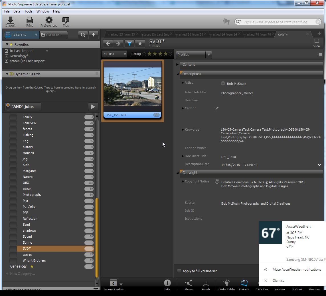

Under the CATALOG tab, I scroll down to the "SVDT" entry and right click (Picture below). Then click DELETE. It is removed from the catalog, but not from the picture (NEF or XMP). Going back to FOLDER View with PROFILE showing shows "SVDT" still there. Trying to remove it there, just gets it readded to the catalog.
How?

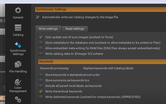

Below is the Preferences Sync settings. I have been using default setting. I see the one "Allow embedded...RAW file.." I assume I should have that checked in my case. Will this cause the data to be written into the original image(EXIF/IPTC)?
Also Keyword processing: What is the difference between "Merge" and "Replace" keywords? Only in the XMP, in the EXIF/IPCT, or both?
BAD KEYWORD GONE
Label Assignment Panel
By selecting the image with the bogus "keywords" while the LAP is showing I can right click on the bogus one(s) and remove/delete them. Then I can go to the catalog tree, locate the bogus keywords/catalog entries(with 0 entries), and right click "delete".
Gone. From catalog and from metadata(XMP).
Thanks.
Bob

Yes, that option controls whether metadata is written to a XMP sidecar file or directly to the original file.bobmcswain wrote: Below is the Preferences Sync settings. I have been using default setting. I see the one "Allow embedded...RAW file.." I assume I should have that checked in my case. Will this cause the data to be written into the original image(EXIF/IPTC)?
On writing, "Merge" combines the assigned labels with the previous keywords in the file (some of which might not have corresponding labels in the PSU catalog), while "Replace" will clear up any previous keywords that don't have corresponding labels. There are similar settings (and effects) for reading too.Also Keyword processing: What is the difference between "Merge" and "Replace" keywords?
My frame of reference is XMP, but AFAIK keywords in the legacy EXIF/IPTC are handled too.Only in the XMP, in the EXIF/IPCT, or both?
