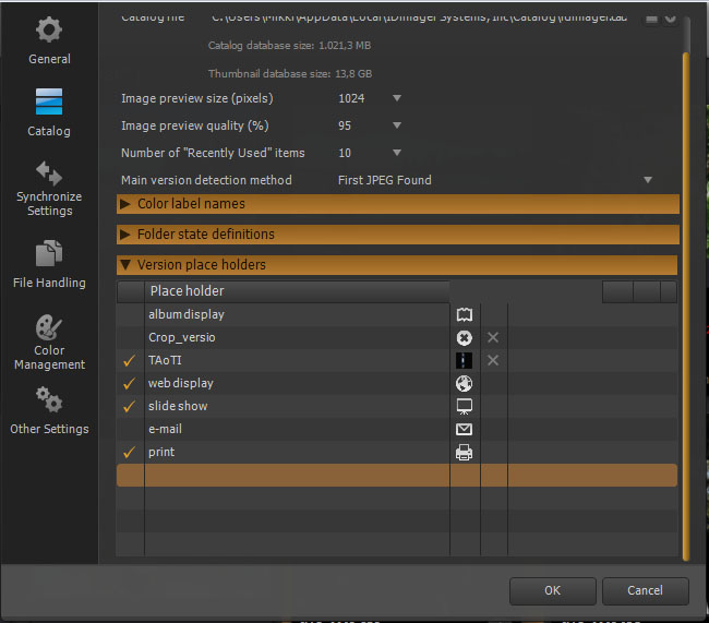

I have defined a place holder named RAW; whcih is the placeholder I want the script to assign the .CR2 file. From this file teh meta data should be copied, and pasted to all version in the version set. It does however not work.
While investigating the issue (hwy the script does not propagate meta data to the other images in the version stack) I noticed, that the version placeholder called RAW is no longer to be seen in Preferences -> Catalog. Could this be the cause for the script not to work?
When manually assigning version place holders, the RAW place holder is availabel...
Version Place Holder named RAW
However it's not listed in Preferences:
Missing RAW version place holder
Kind regareds
